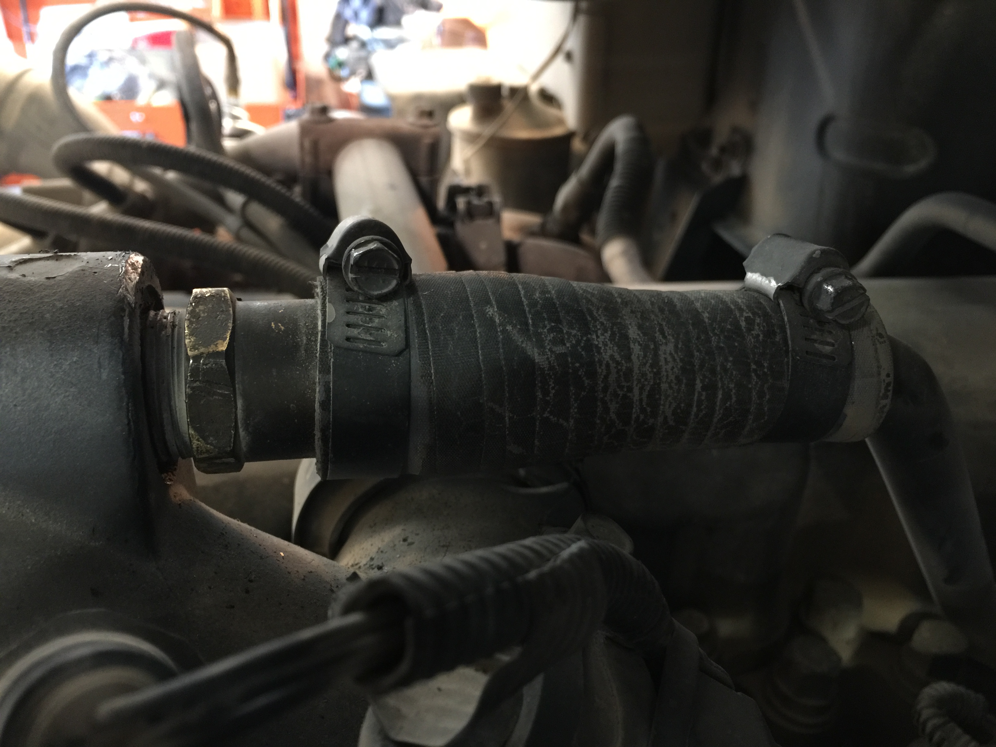

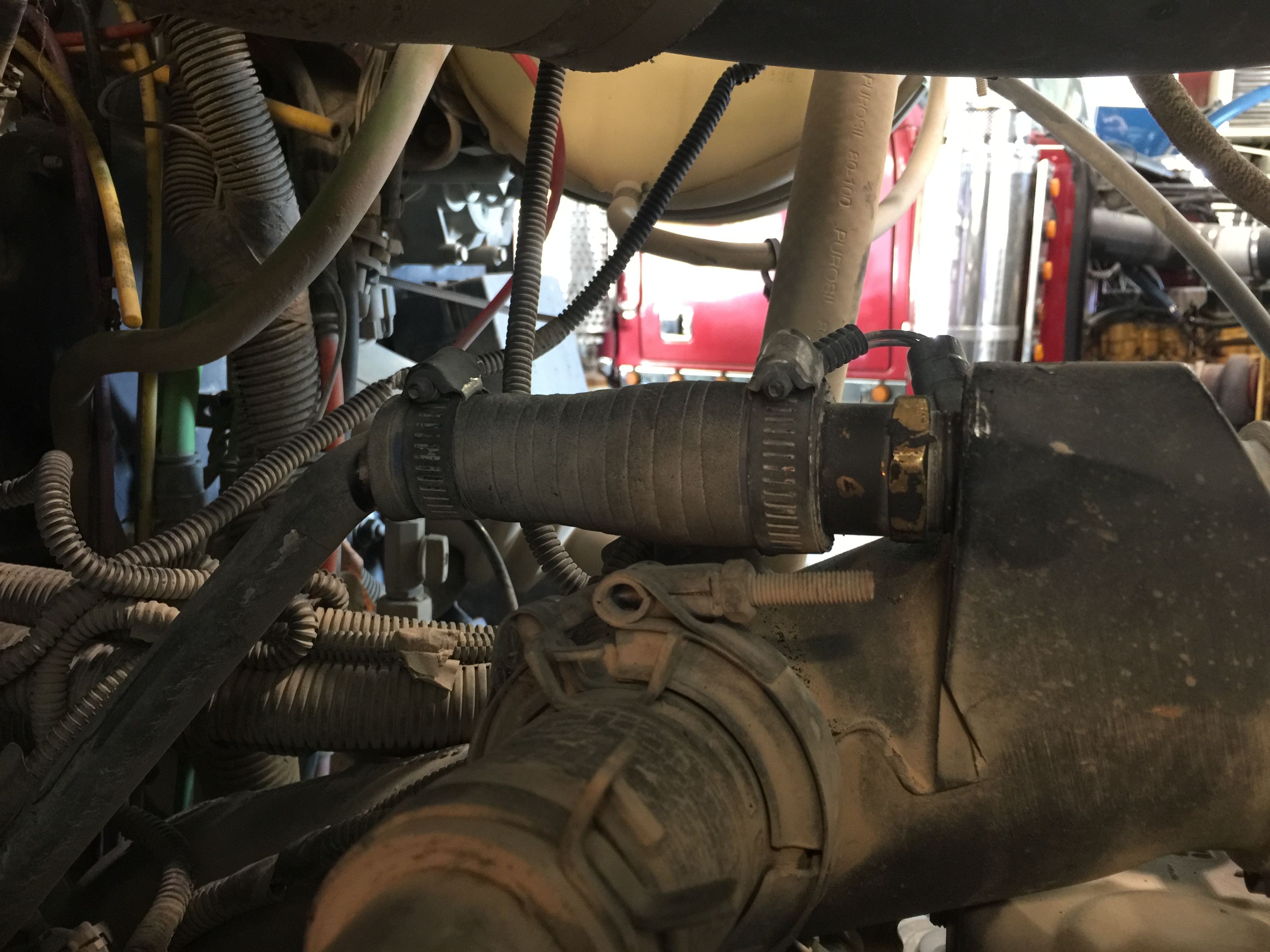

You should have around 33 psi boost , check air filter, check muffler for broken baffle.  pressure test entire intake system , not just the after cooler. Also a big over looked part is the boost pressure relief valve on top of the intake manifold.  Ill attach pictures of what it looks like soon .
