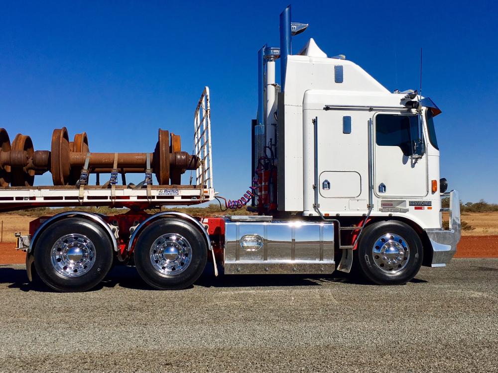

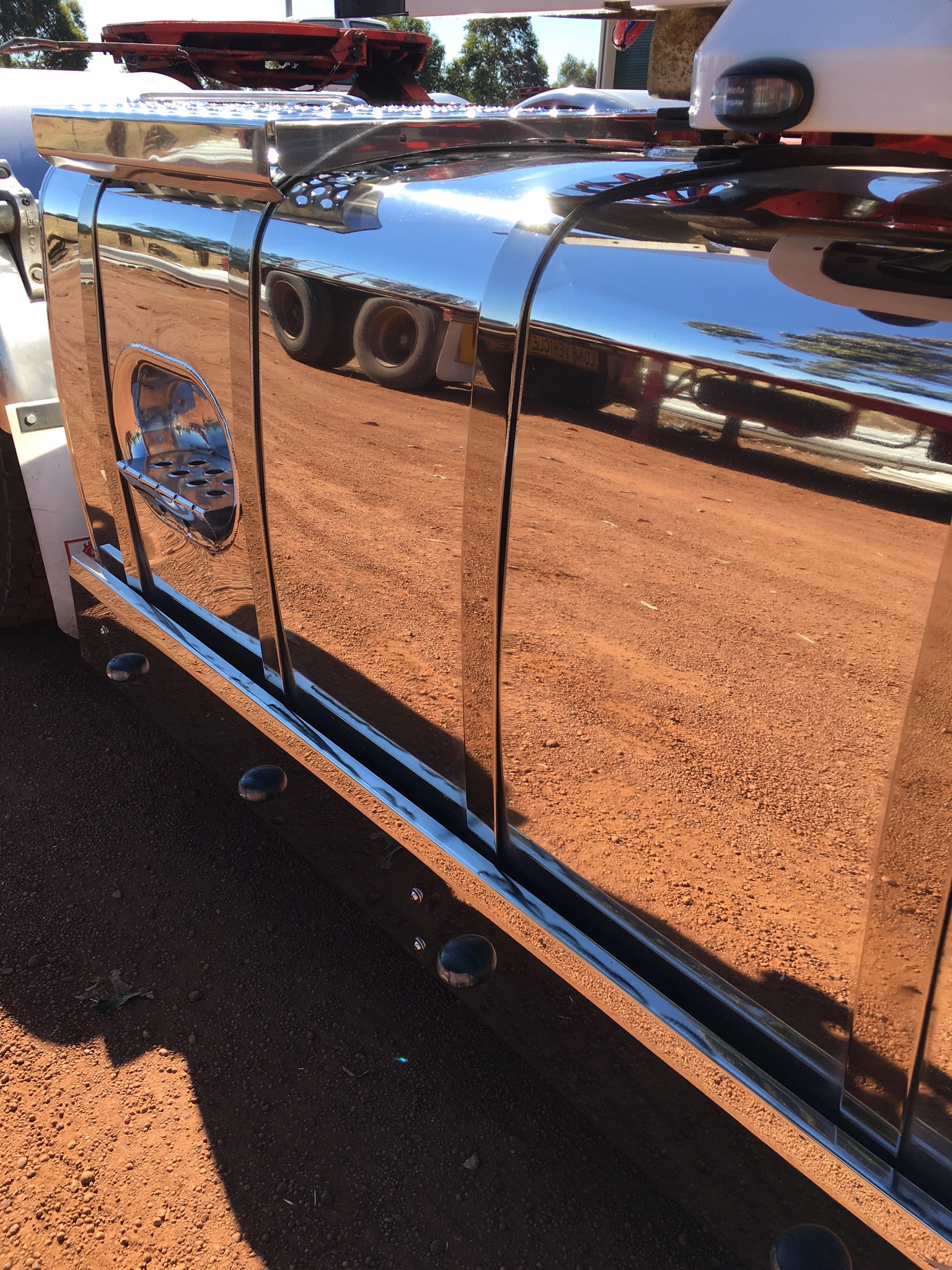

Yeah it's a great product and easy to use. I used a 9" angle grinder cause to get desired results you need 6000rpm. Most polishers only go to 3000rpm. You have to hold on tight! Sure has some kick.

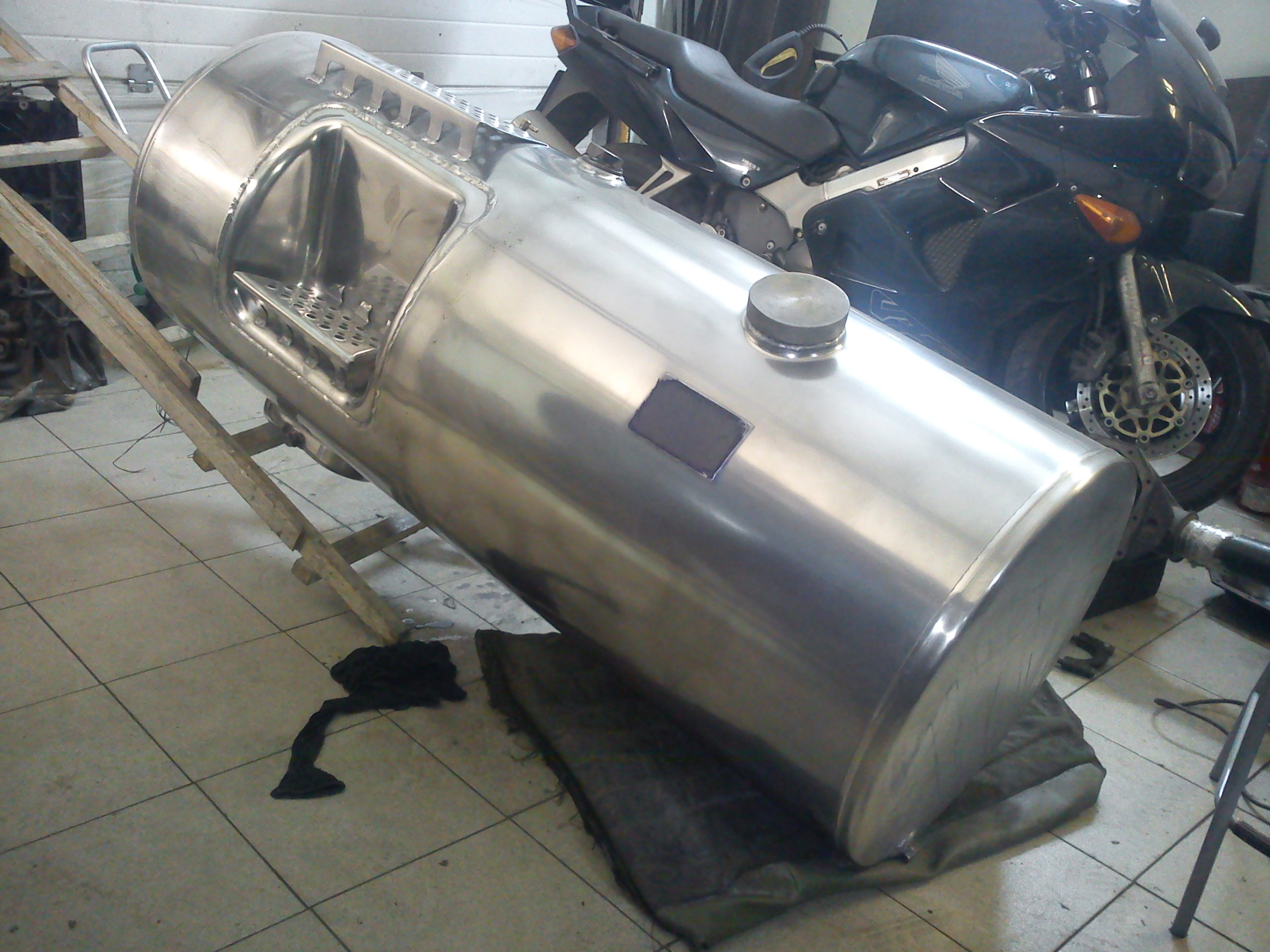

Of all the stuff I could find locally the best result was achieved with 3M Marine Polisher, and I'm not satisfied with it.
Not bright as hell and difficult to work with. Hand polishing is the only way. So I will try to put my hands on something more successful.
Edited by Vladislav
Share this post
Link to post
That tank looks like mine on the RS when I polished it out since they were never polished at the factory they need to be sanded with 800 grit them buff them again to make them like a mirror.
Edited by ranchhopper
Share this post
Link to post
Vlad, that's a nice looking tank. I think ranch hopper is right, if it's never been polished before then you might need to sand it back first. We were lucky as most of the aluminium on our trucks was polished at the factory so it's just maintaining it. And a lot of it is trial and error.
Share this post
Link to post
Guys, my trouble with that tank was in a different ball park. It was never polished before indeed. And lots of pitting as a follow. Starting from that point I ordered one of my boys with a grinder to sand all off. He started from 120 grit but had to step back to 60. Spent no less than 3 days getting tonns of alu dust until the most of cavits were gone. Probably sanded off something like 0.3 - 0.5 mm of the wall thickness. Than he followed with all sand papers step by step. That time I went for a trip for a couple of weeks. Found him still sanding when back home! Finally he ended up with 2000 paper having almost no scratches, pitting and so on.
But when it was a time to polish that aluminium showed its character. I couldn't do anything with it by common "green" stuff and applied the mentioned above 3M paste I had very good results on Alcoa wheels. It turned out as good as you can see. Nothing better. You have to apply the paste with a piece of cloth. You start rubbing it and found it gets brighter. But the paste becomes to be a black stuff at the same time. So you have to remove all the rest of it until it dries. If you dont it sticks to the surface and the only way to remove is 2000 sand paper. Just a nightmare.
Sure I made research on the materials to polish aluminium which are in stock overhere and found nothing to work better so far. Going to try order something else from the States or other country. But there are difficulties with importing liquid stuff.

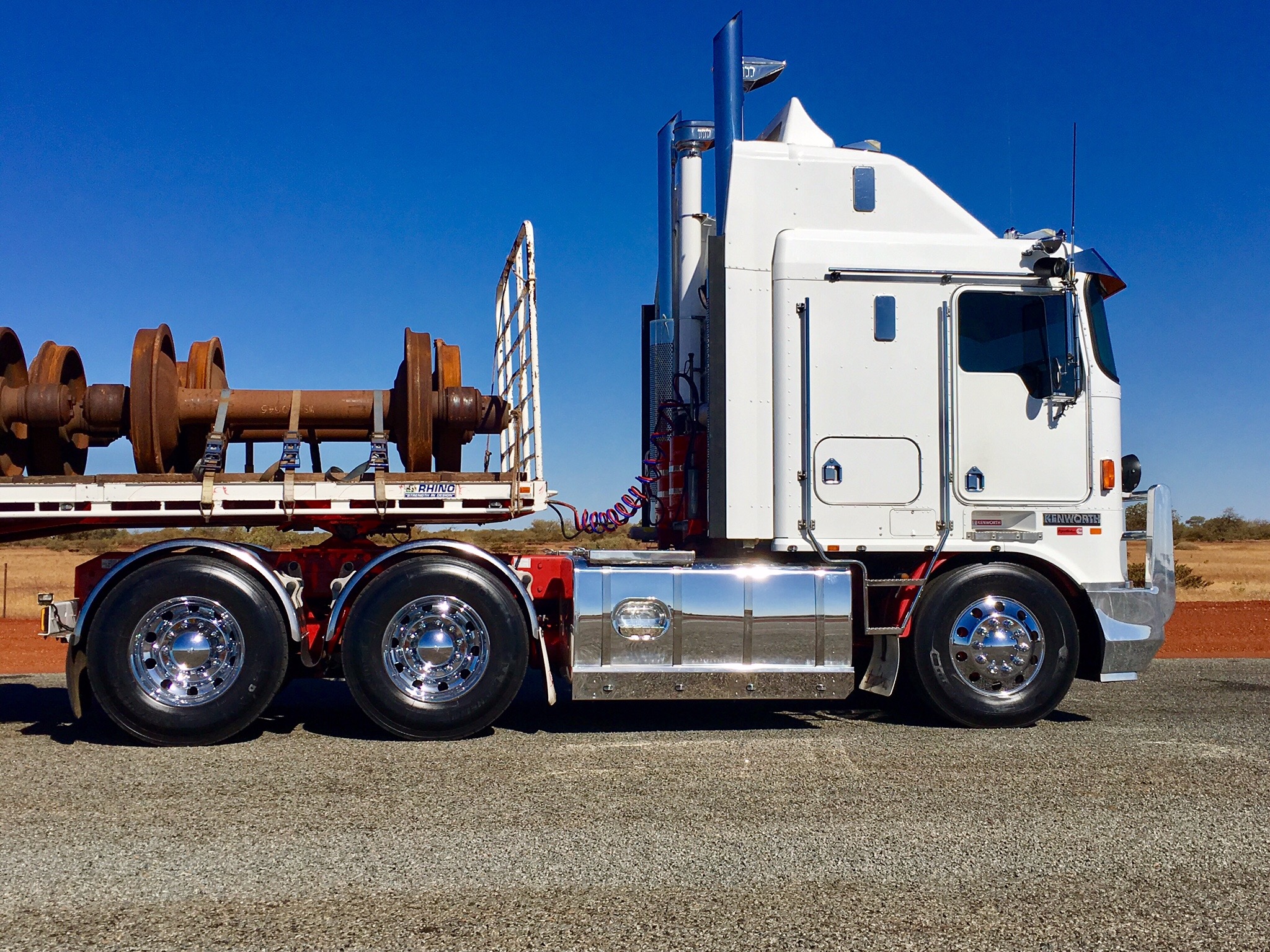

I hate to brag, but I been working on my MH tanks a bit too.(since you guys opened up the topic)ad0d609c67445f179505a64722b3b485.jpg
Here's a good before/after picture.
Finished product installed back on the truck over last weekend. For a working truck, I am happy with the result.
