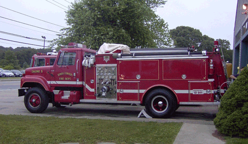

I drove an '85 International pumper when I was active in my department, and it had a Detroit 671.  Loved that thing!  Sure, when you started it up it would put out a cloud of smoke that would kill anyone within 300 feet, and if I was home (2 miles away) and someone else took it out for a spin (which not many could do - it had a 10-speed Road Ranger that about only 3 of us in the department could drive) I could definitely hear it leaving the station with no doubt about what truck it was.
But in the 7 years that I drove it before it went out of service, it was pretty much the most trouble-free engine we had, and very forgiving - you could lug that thing down to 5mph in 7th or 8th going around a corner, and it didn't much care - just punch it (there's that cloud of smoke again!) and it would pick up right where it left off....  I pumped it at quite a few fires, and I still miss driving it.
I wanted to buy it when it went out of service, but it wouldn't fit in my garage.  It's for sale now, but it's been sitting outside for about 8 years, and the seasons have taken their toll.  If things go as planned, a friend and I will take ownership, but we'll have to evaluate the cost to restore it.  I have a feeling the next stop on its journey might be a conversion to a dump truck, unfortunately....
On the opposite end of the "loudness" spectrum, we also had an '84 Pierce/Ford cabover with a CAT 3208 that I think is the quietest truck I've ever driven.  I've been in cars that were louder than that thing was.  It was slow as molasses on the road, but sure was smooth!
