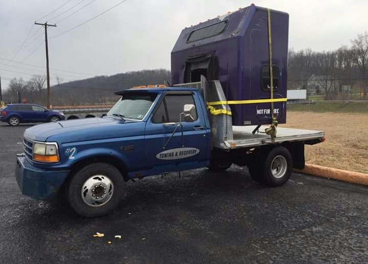

So I bought this sleeper on Christmas eve for on my superliner, thought it looked like the ones on the liberty editions, but I see now they have 2 windows up top. Also, after further research (after I bought it of course) I see that a sleeper on a superliner from factory has the corners cut out for the exhaust. I think I have an idea for that when installed tho. My question is, how should I got about installing this? I didn't measure the opening on the sleeper, but it's more like our Kenworth with a flattop, not an upside down triangle like a Mack hole. Should I cut a square hole in the cab to match? Or "fill" the opening of the sleeper to a Mack style opening? Do I need to brace the cab after cutting it open or is it okay being an all steel cab? was planning on using that accordion tube as a gasket. Thanks for any  help or advice in advance.

Can't offer much assistance as for cutting the truck to fit.  When I did my B model I cut it out to match the bracing on the back of the cab and adjusted the bunk to match.  I then cut and adjusted the original boot to fit.  No problems, never a leak.  Then I had to go bang it up....ugh.

Just my inexperienced opinion is it would prob be better/easier to make the bunk match the cab.       If you modify the back of the cab you won't have factory style interior peices to match anymore. The front of the bunk could have a large peice of aluminum plate bolted/rivited put on the front to make the ne opening.  it would be hid behind stacks and inbetween bunk and cab out of sight.        There is a guy on here in the process of putting a KW on his superliner I believe.   I'm horrible with names but pretty sure it's AZ something or another.

Thanks for the advice. freighttrain, you would probably be jealous if you knew what I (think anyhow) stole this for.
Hobert, I believe that is what this sleeper came from. I tried searching the forums but no luck, most likely operator error. But that makes sense. Interior will be getting a makeover also in this process.
