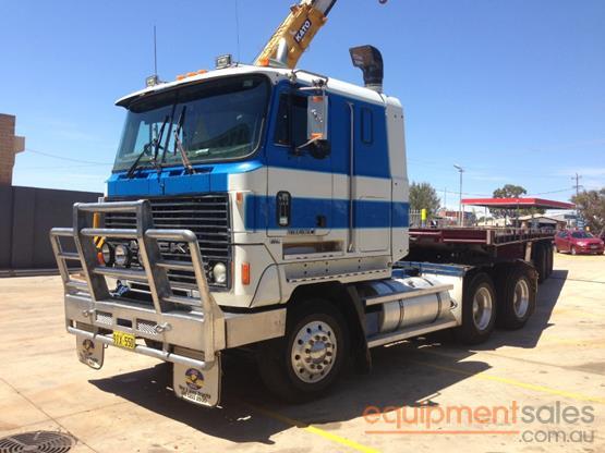

As long as the thread has drifted off to include the MH, I seem to remember a picture in Truck magazine of an MH prototype with a setback front axle, story said it was intended for Australia. Did the set back front axle MH ever make it into production?
I'm unfamiliar with that for Oz.
Here's one. I guess it did make it into production. Mack Trucks Australia generally did things their own way.
Perhaps the US experience with the shortcomings of the early Cruise-Liners and Super-Liner led them to adopt the tried and tested R model frame for their Cruise Liner, Superliner 1 and 2 and later, the MH Ultraliner. The Australian Value-Liner was also a completely different beast from the US one, again being based on the R model frame. Perhaps the set back axle MH is a kind of COE equivalent of the Aussie Value-Liner which also had a set back front axle.
Thanks for the photo! Looks like they only set the front axle back a foot or so, maybe because their would have been too much weight on the front tires otherwise? I'll have to dig through my old copies of "Truck" and see if I can find the article on Mack with the picture.
