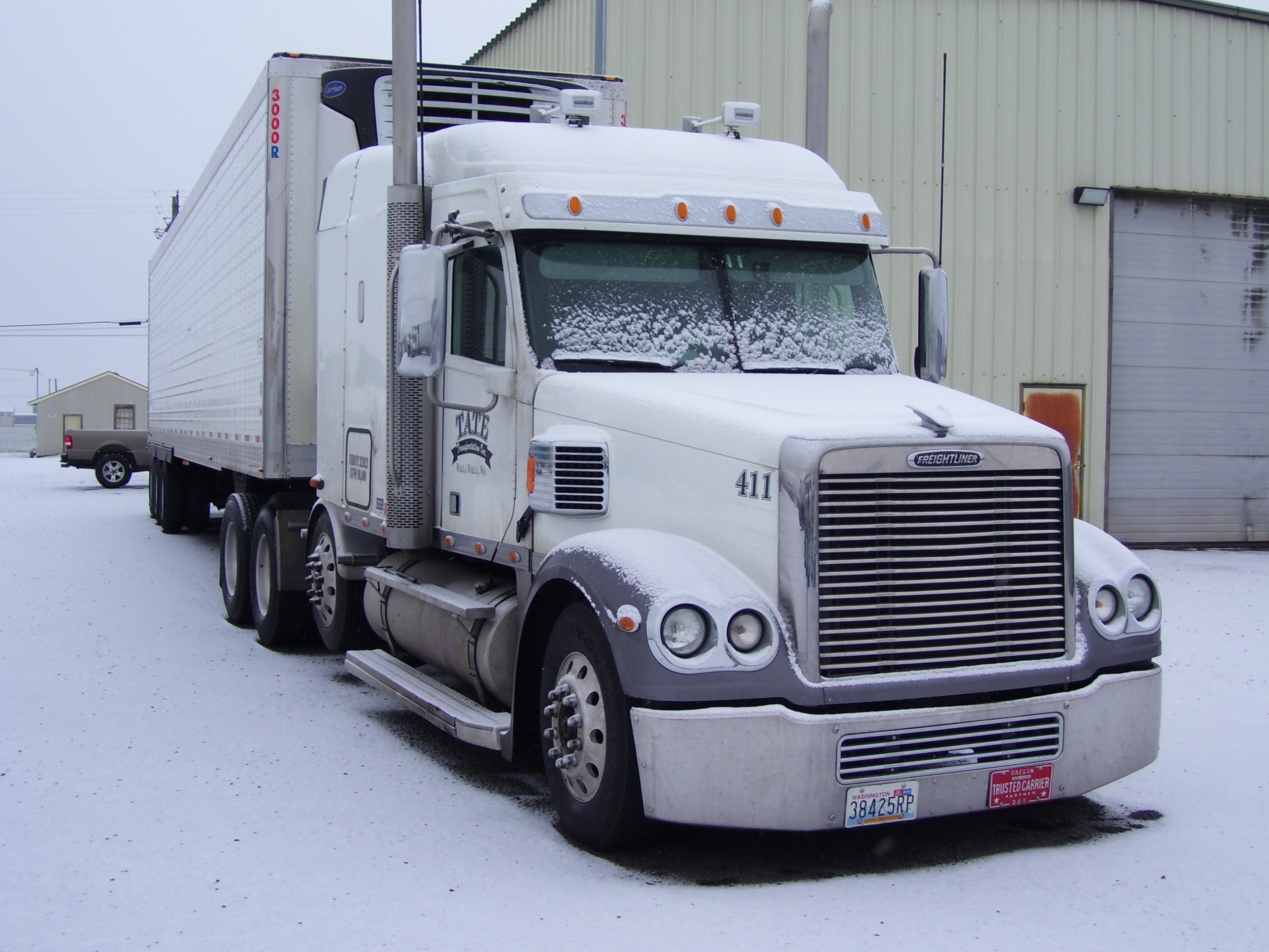

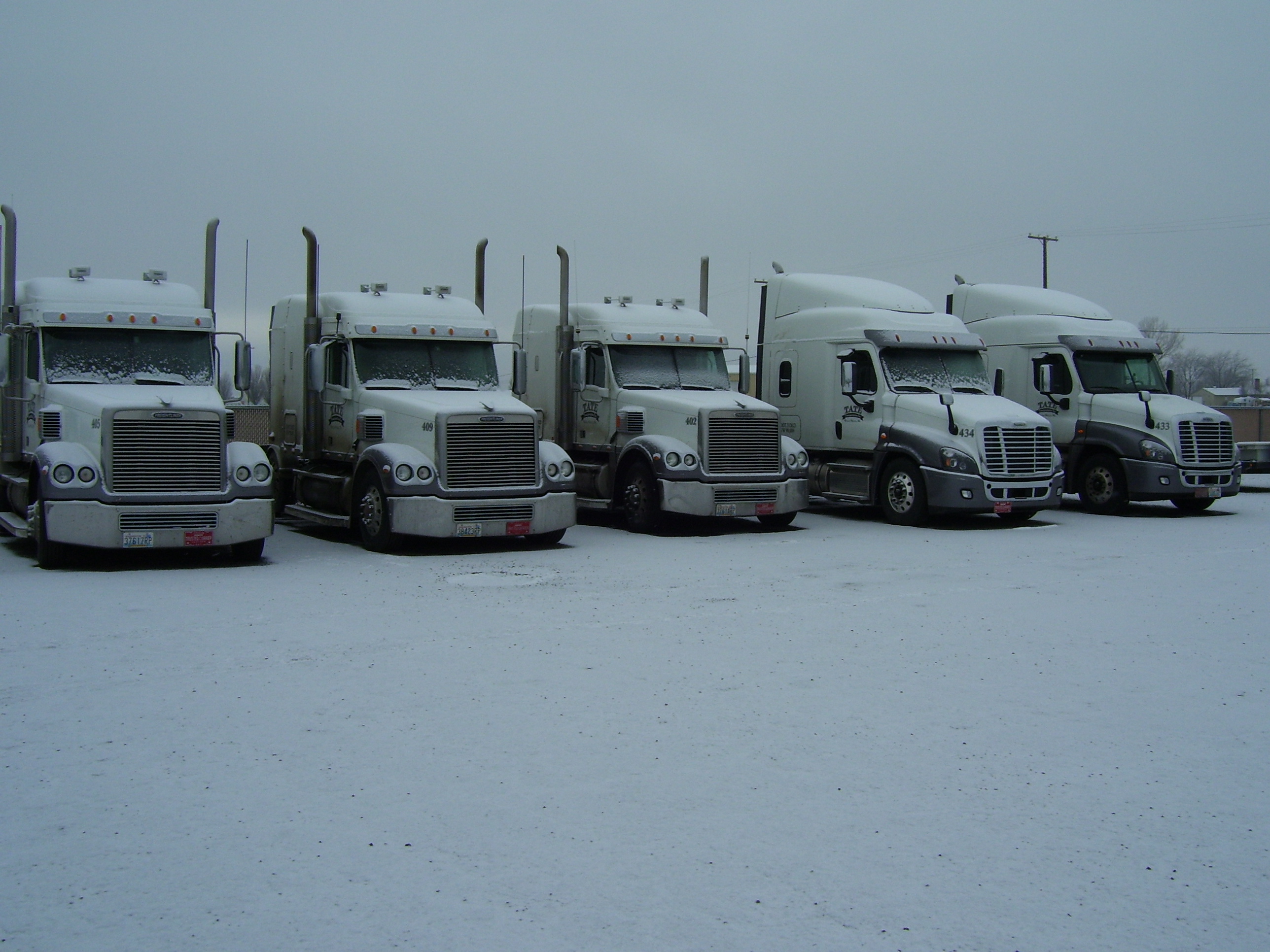

The company I work for operates total of 45 OTR tractors and 68 trailers, 20 of the tractors are 2012 Freightliner Coronado gliders. I know Freightliner:wacko:.
Those trucks are equipped with 2004 Detroit series 60 550 HP. To be considered a glider it must come minus two major components, trans and rear drives.
But these have been pretty good trucks for us. We couldn't beat the price either.
