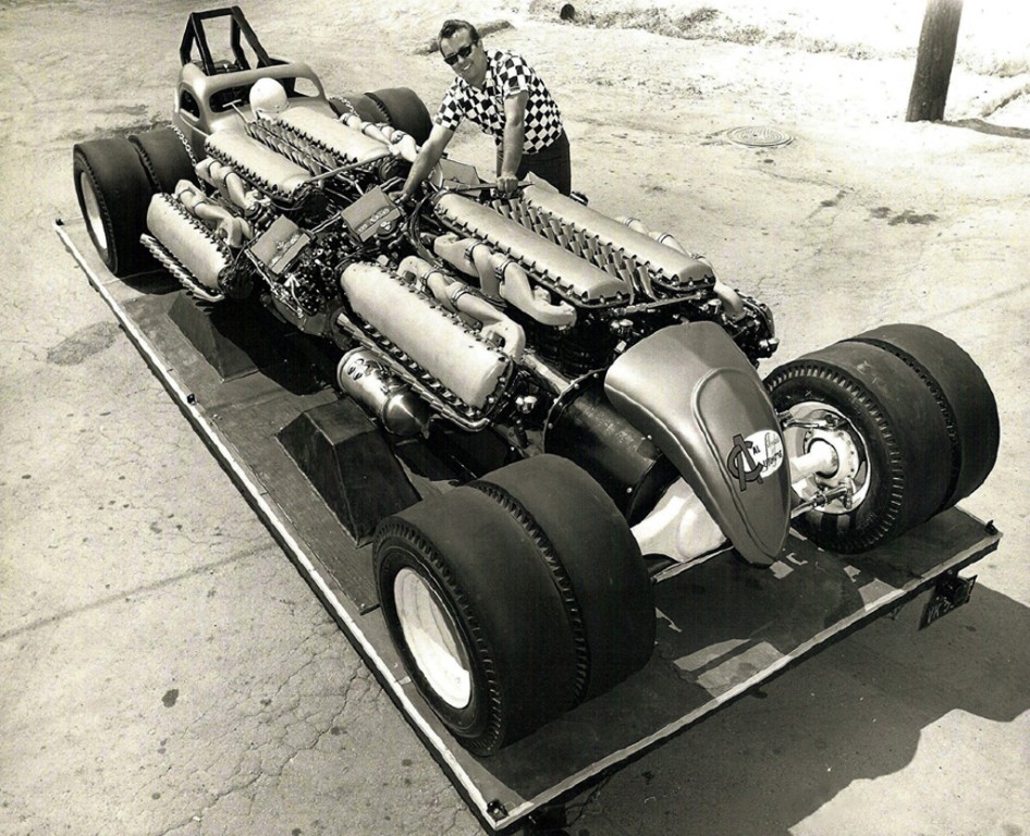

Wow! Knew they had a few dragsters,tommy ivo's four engine rail,and a couple hemi two engine dragsters,also a couple land speed record racers,but that's the first  Two engine truck I've seen! I do recall something about the two engine flathead tks. You mentioned,may have been in overdrive magazine. Love to restore that two engine cabover and go to a truck show and quietly disconnect the driveline and related parts (with everyone thinking it's one engine and slide out the two engines!!)

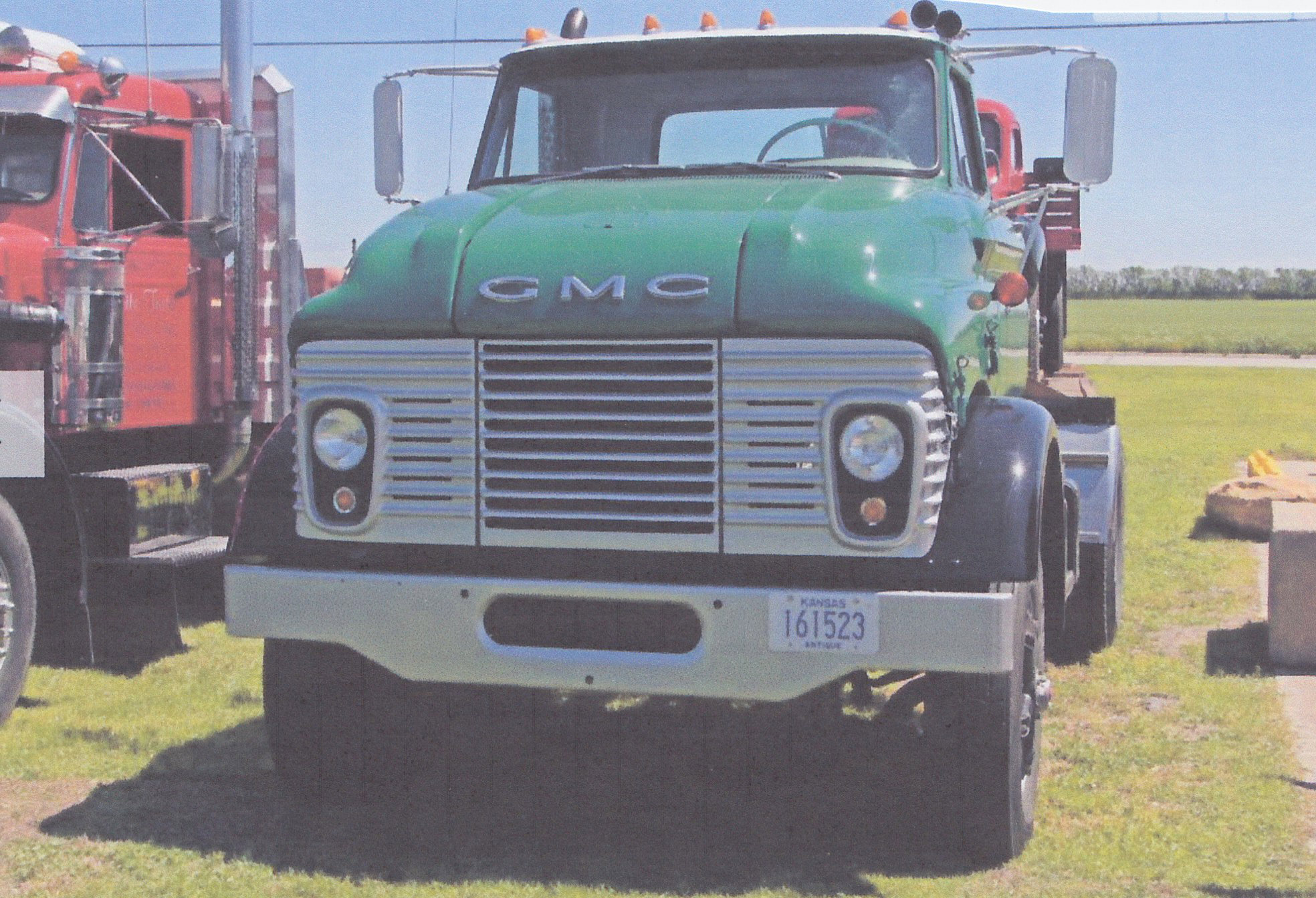

                                          I remember this truck well , I was eight years old when it came by our dairy to pickup the milk every other day. 1964 GMC V12 gaspot. It wasn't two engines but
                                          it was based on that concept. It used four V6 heads and one block that was designed from using two blocks. 702 Cu.In. 275hp. The one came to our place was a
                                          5sp using a single two speed rear axle pulling a 38 ft tanker. It had twin five inch chrome straight pipes that were blue at the elbows. I went to a six room school
                                          a mile from home. I remember that I could tell that Gene the driver was leaving our farm after picking the milk up at 9:30 am. I could hear that truck setting in
                                          the classroom.                 This truck looks just like the one when I was a kid.
                                           http://thunderv12.com/
