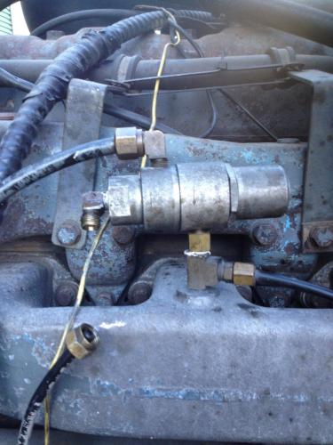

Came across Lmackattack's write up on putting the puff limiter on a switch in cab.  Before I did anything like that, I messed around with vise grips on what I thought was the correct line to see if it worked.  I put a piece of rubber around the line before I clamped the vise grips down so I didn't damage anything.  Got in the cab and took the parking brake off and mashed the throttle.  No change.  Long story short, it's like that for every one of the 3 lines coming off the valve.
What'd I do wrong here?
Yes the truck has a working pyrometer.

That's what I'm working towards, but the line I thought was the correct one has no effect on how the truck runs.  I'm just trying to test it out before I build a switch for it.
Edited by xdudebrahx
The air line your after should be 1/4 in. Mine has two 1/4 air lines, and one 1/2 in.
You see in my picture one air line is off, that's the sucker right there. It should be energised when brakes are released.

Gotta bump this again.  My usual truck came back from the shop and upon checking it out, I noticed a new reversing relay installed on the intake manifold.  The issue is that the shop left the pipe plug in the rearmost port and the airline is leaking since it's not connected.  I jammed a screw in the line so the truck would build air pressure.
The mechanic will eventually fix it but I'm asking for my own knowledge.  What is that line?  The one on the front is the one that goes to the puff valve on the fuel pump, but what are the other two?  I'm thinking one is a supply line and the other goes to the trans for reverse?
There's only three ports on the reversing relay valve. The one in the very middle should be mounted on the intake manifold (signal pressure). The other two, I can't remember which one is which anymore. One goes to the puff limiter cylinder(front of pump) the other should be marked in and is the supply from the spring brake air circuit.
