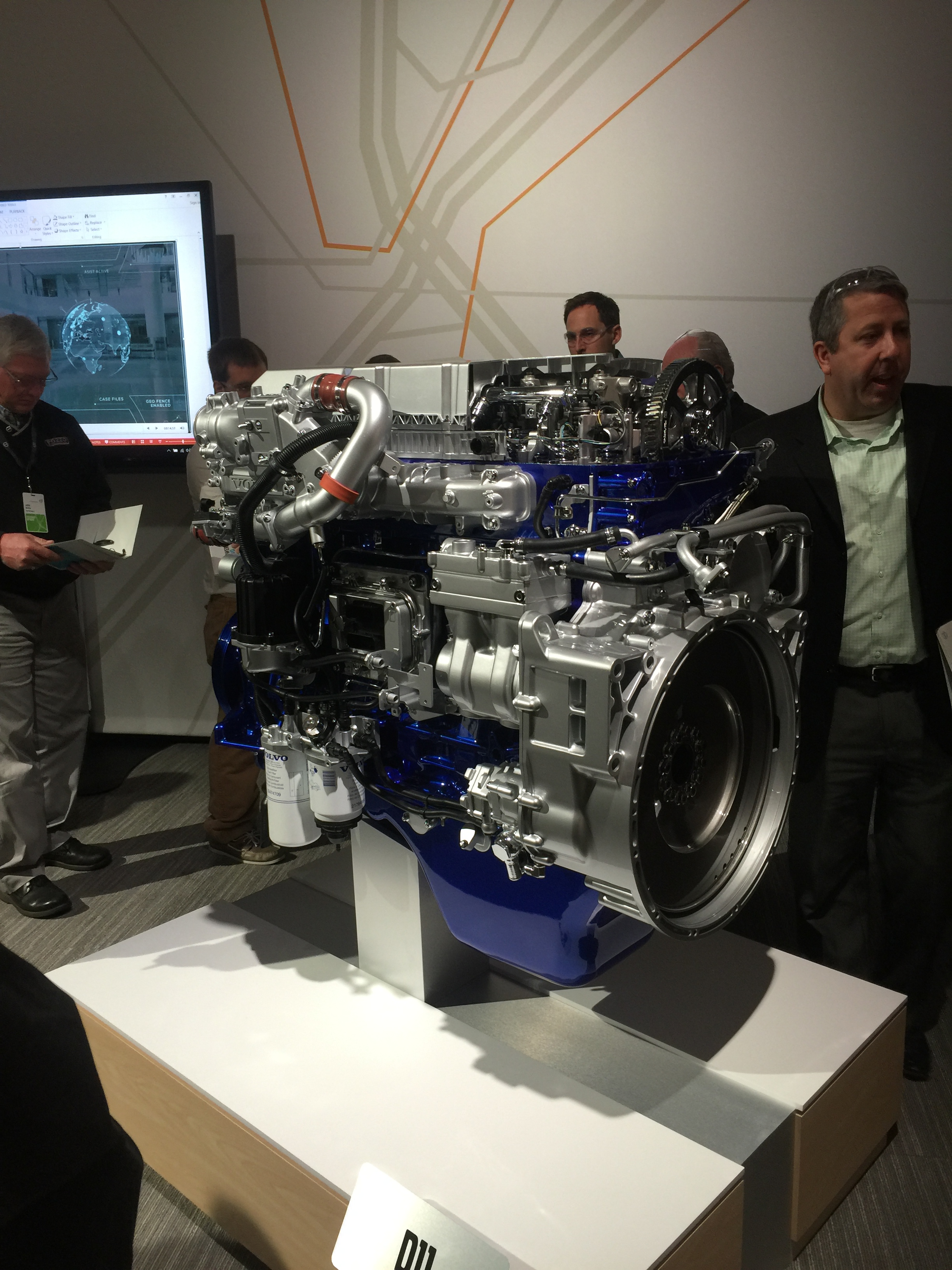

MV might be calling it common rail but the only thing common is the new engine still uses IU'S to make the fuel pressure off the cam. So here is the details that I know. The new mp8 will have 3 IU'S making the fuel pressure and 3 non pressure injectors tied to the pump injectors. No real change in the cups or the base platform. The fuel pressure has been dropped to 25000. some changes made to the cam and rockers.
overall. much of the new engine is just a sales pitch. MV has never figured out their issues with injectors and cups and is still clueless. it's a shame.
good luck to anyone who buys one. no more MV for me. MV won't stand up for their products even when it is clear that the injector/cup issue is a rampant problem on any truck.

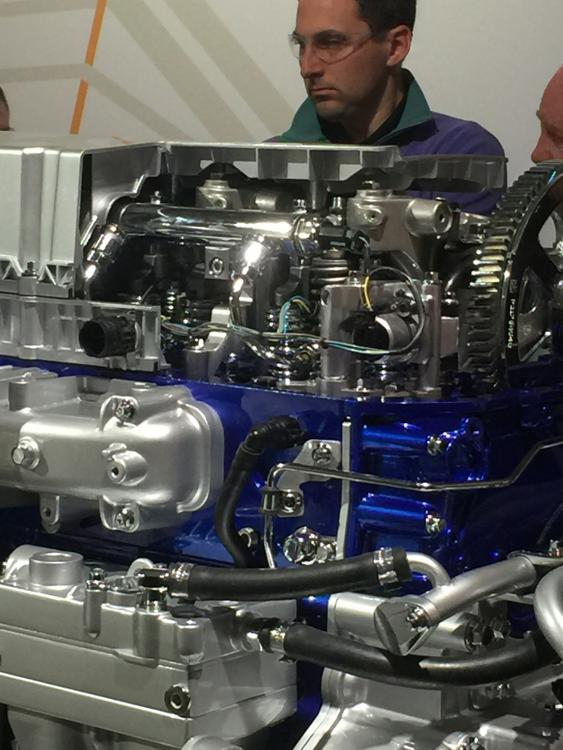

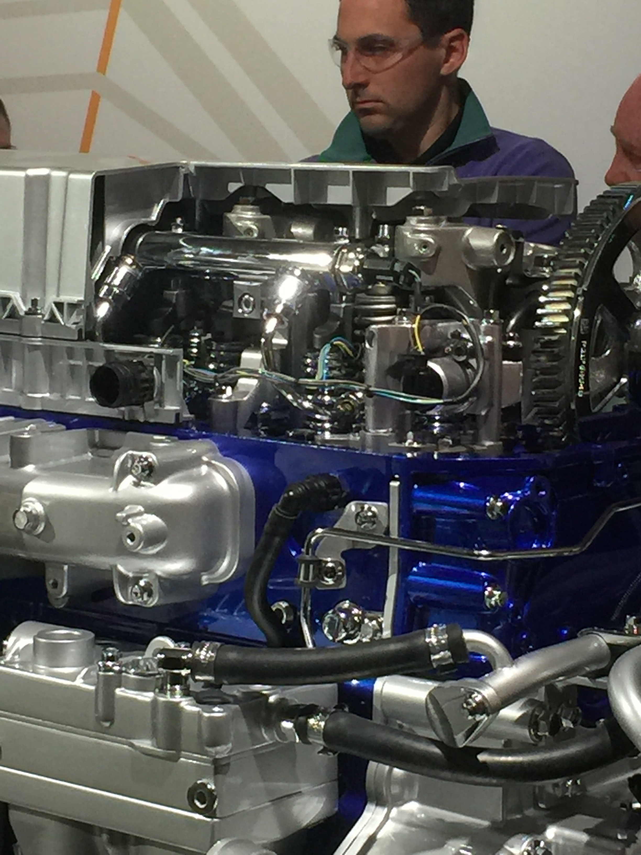

You may notice the display engine in the picture making the rounds is missing external fuel lines to feed the rail under the valve cover.  It's not a complete mock up.  I'm thinking (and hoping) this is a bridge engine and that there is another engine currently in the works for release at a later date.
On 9/17/2016 at 1:00 AM, fjh said:
Yup
A couple of Large fleets up here have made decent orders months ago to avoid having these engines in the trucks about to be built.  One customer has been a regular tester of new Mack powertrains for decades.  He has had enough of the failures in the last 15 years of product development.
I believe the use of the 3 plunger unit injectors may have to do with a principal that Detroit/Benz uses on the DD series  with an extra set of injector holes in  each injector tip.
 Detroit/Benz has them on all 6 injectors and the higher then common rail pressures are made by using fuel pressure as its mechanical/fluid advantage to increase injection pressures at the tip.(basically the same principal as CAT and Navistar's use of HEUI injection systems. its ported through the head separate from the actual injector fuel supply only being used as a form of hydraulic advantage.
 The lower pressure is fed to each injector by the fuel rail.  The DD engines use both sets of tip ports for every cylinder injection.  Metering and duration increase for high power demand and regens.
 On Volvo/Mack The 3 Unit injectors ( that will have 2 sets of tip ports? )will use the rocker arm plunger as its high pressure actuator (Instead of a HEUI like system) when needed on the one set of injector nozzle ports while the common rail will feed the lower pressure injector ports (on the unit injectors with plungers only) The mechanical plunger will be used to amplify the common rail pressure most likely.
The other 3 injectors will be fed by the rail only and have a single set of nozzle ports at the tip.    (I have yet to confirm this but it makes sort of sense to me)
Why Mack/Volvo will only needs 3 cylinders to do this is strange to me.
Lets see if my hypothesis is correct, as nobody at my dealer has been trained on these engines yet.
