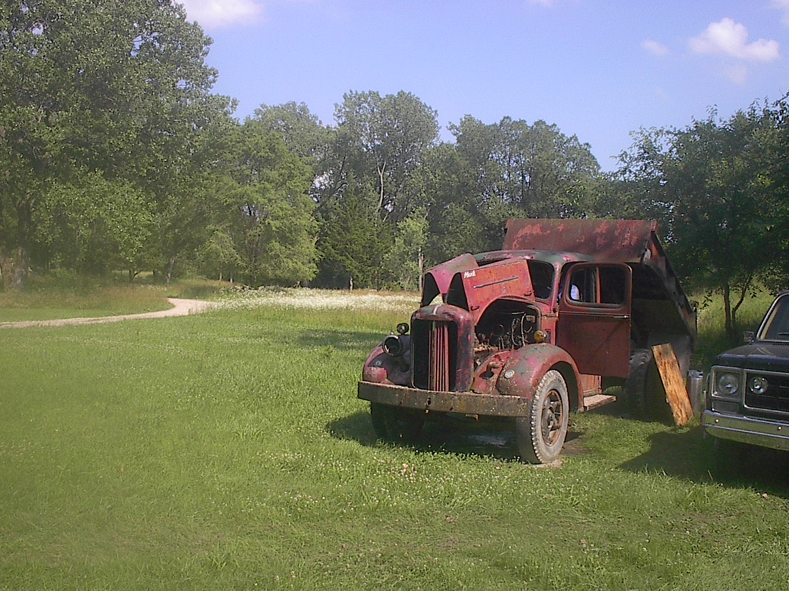

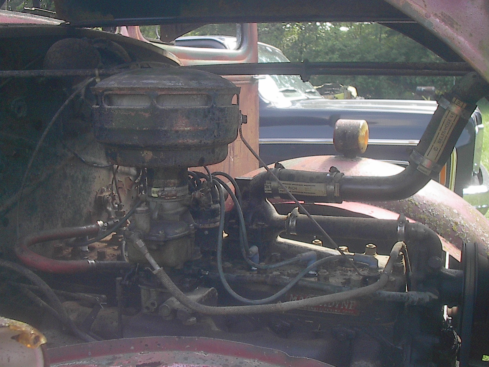

Thought I would update my posts about my old Mack. A couple of months ago when all the snow went away I got back down to the quarry to play with the Mack. Took the carb apart and found that the accelerator pump does have an adjustment on it, so, I played with that a bit and also played with the timing. That seemed to cure the hesitation when hitting the gas, now I've got good throttle response and of course that makes it a lot easier to shift those gears. I was so happy! Unfortunately, for the last month or so it has been raining, and raining, and more rain. Yesterday, I heard on the news that the creek that borders the quarry had flooded. Drove down earlier this evening to see what had happened, not good. The water had come up about 4 inches above the floorboards, engine is filled with water and I assume the transmission and rear end are also topped off. Depression has set in and of course it is lightening out and raining again. I still have hope that if it ever stops raining that I can drain the water and hope that it has no severe damage. Has anyone here encountered this before? When I drain the crankcase should I also pull the plugs and put some oil in there, hand crank the engine before attempting to start it? Any ideas?
Get the water out as soon as possible. The water will settle to the bottom right near the drainplugs. If the truck is where you are going to work on it then drain it there. If not just crack the drainplugs loose till oil starts to run out after the water then tighten the plugs back up. Anyway don't leave the water in there as things will start to rust. Hopefully nothing is stuck or frozen from rust.
If you can drive the vehicle for a spell things will get warm but I would just get the truck to where you can service it and drain the fluids, then refill after letting them drain for a couple hours to overnight if possible. If things still move chances are there is no real damage but do get the water out as quick as possible.
Rob
Thanks for the advise Rob. I went back down to the quarry on Friday and drained the fluids, got 8 gallons of water out of the engine, 2 gallons out of the transmission and another 2 gallons out of the rear end. Pulled the plugs and shot some oil into the cylinders then let it sit while I cleaned up the rest of the campsite. Refilled the fluids and cranked it over with the plugs out to try to blow anything out of the cylinders. Put the plugs back in and it pretty much fired right up. :thumb: Seems to smoke a little more than it used to so I got it warmed up then let it cool, then warm and cool again in the hopes that the rings might reseat again. I don't drive it enough to worry about oil consumption and this just might keep the bugs down! Then I bled the brakes to flush any water out of there and took it for a test drive. Seems to run just fine so I'm happy again. Now I can get back to gathering firewood and grilling out, pictures attached!

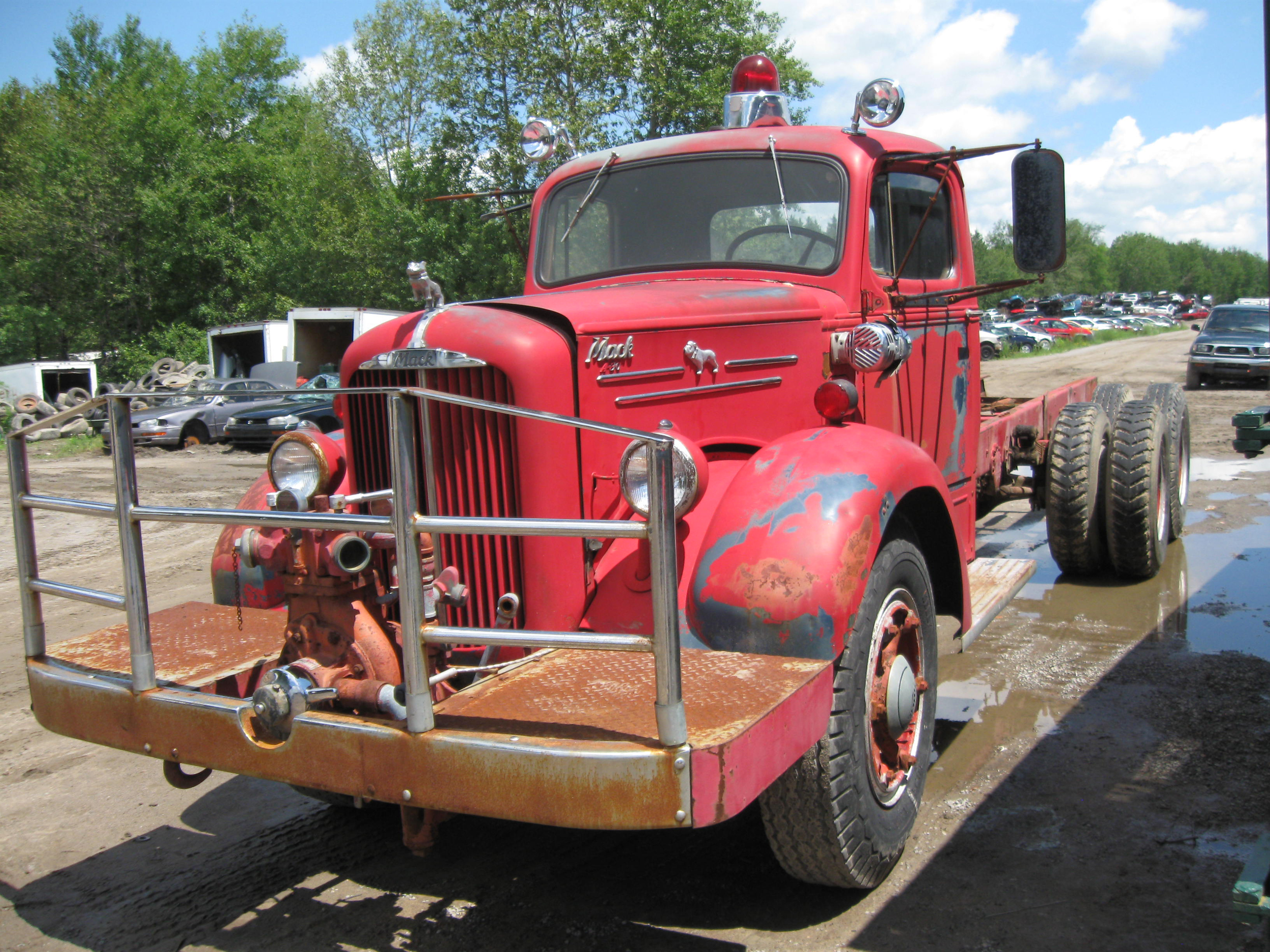

Hi i'm the proud owner of a 1952 Mack A-30. It was a water tanker for the La Rosa F.D.
Was single axle but has a weird after market tandem setup on it to hold the extra weight of a full tank. i will get some pics of the truck and all other info to you soon. I'm in Ontario, Canada and right now the truck has a foot of snow on it but will get serial# soon.
