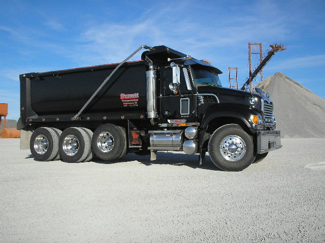

black truck has an OX AR400 3/8" thick body, the white truck has an R&S 5/16" thick AR450 elliptical body, both hauled everything from sand to broken up concrete with rebar in it and not a scratch or dent I can remember, the R&S was a little lighter than the OX, maybe 450lb.
