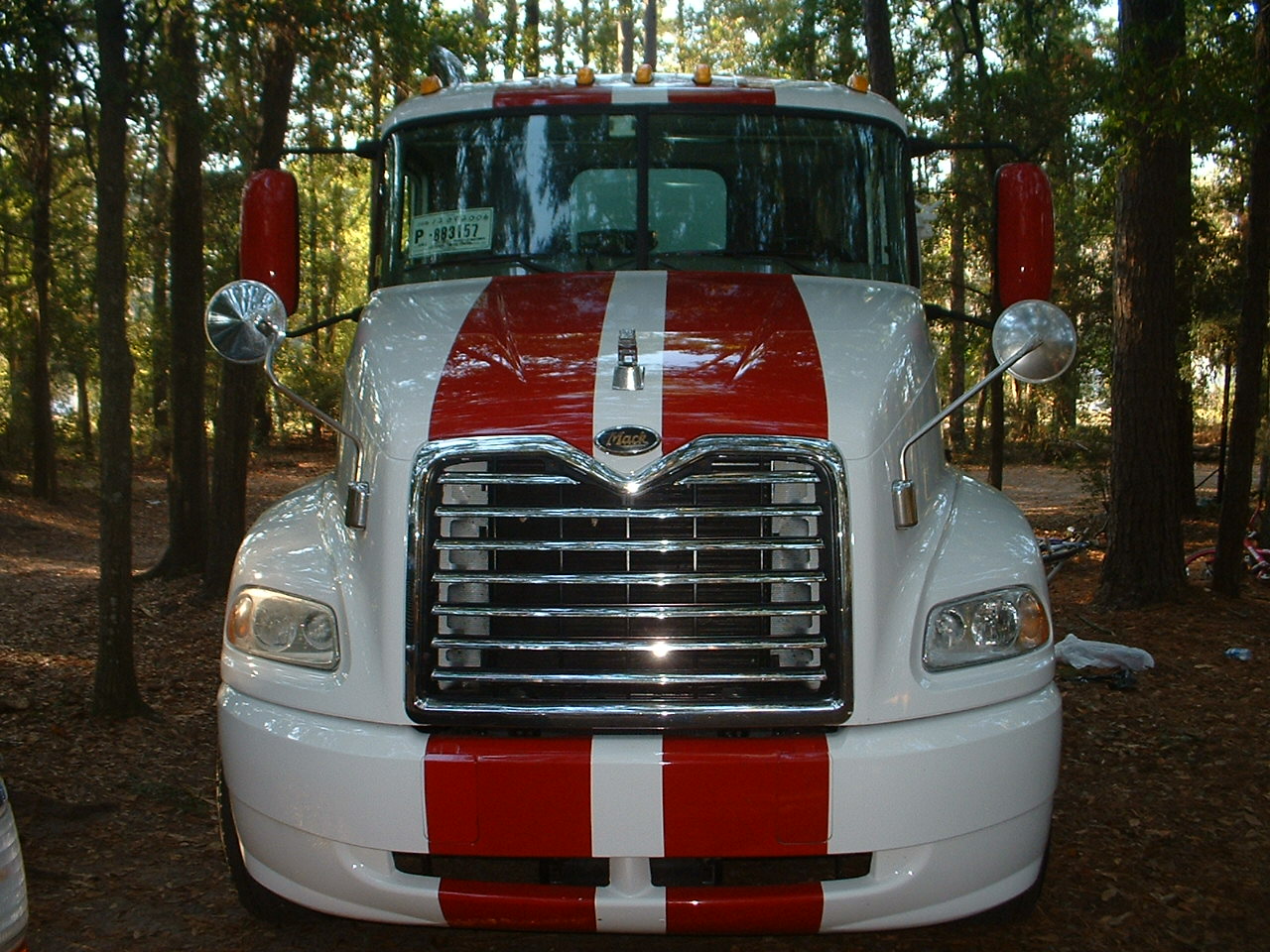

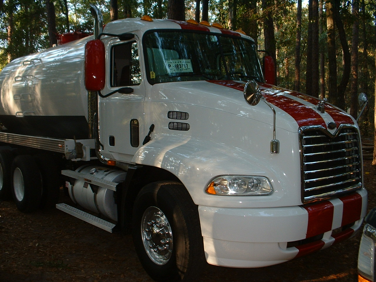

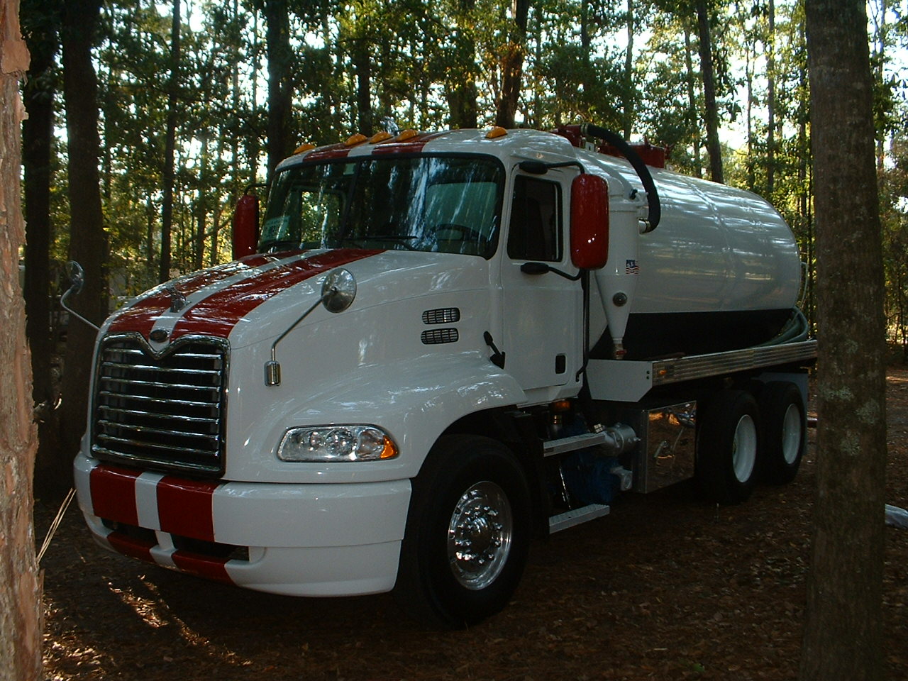

post-953-1163286767_thumb.jpgpost-953-1163286793_thumb.jpgpost-953-1163286809_thumb.jpgHere are the pics of my 2003 Mack vision. It was a sleeper but converted to a day cab and refurbished. It has a 3600 gallon tank for septic pumping. I have it all figured out and actually did 2 service calls this afternoon. Thanks again for all the info.

Looks good!
A septic pumper co. up here has the following message lettered on the front of their trucks: "USED FOOD HAULER", and on the back of the tank it says:"THIS JOB SUCKS"
Just thought I'd mention that.
Share this post
Link to post
What a beautiful truck. Partial to white, those stripes are a knock out. Glad you got it figured out, enjoy.

:SMOKIE-LFT::mack1: nice truck you have there can you put some lighter fotos on the forum thanks :SMOKIE-RT::mack1::bulldog1::thumb:

Slopoke: Very nice looking CX. One of the septic pumpers up this way claims "No. 1 in the No. 2 business"
Mackboy: If you see the images dark, I would bet your monitor is failing, We went through that on our old computer. It made viewing most pics very difficult, unless they were taken in a very bright room or in very bright sunlight.

I think he is talking about the shadetrees, good looking truck, but in the sunlight i bet it would realiy shine

Thanks for the feedback I will get better pics tomorrow I live in the woods so the shade doese make a difference. I was going to take some today but my wife told me she was going to pack my bags if I touched the truck at all today so I had to finish the roof on her porch. As far as the sayings Ours was at one time "Your Sh%@ is our bread and butter" and it always "SMELLS LIKE MONEY" :blink: Thanks Will

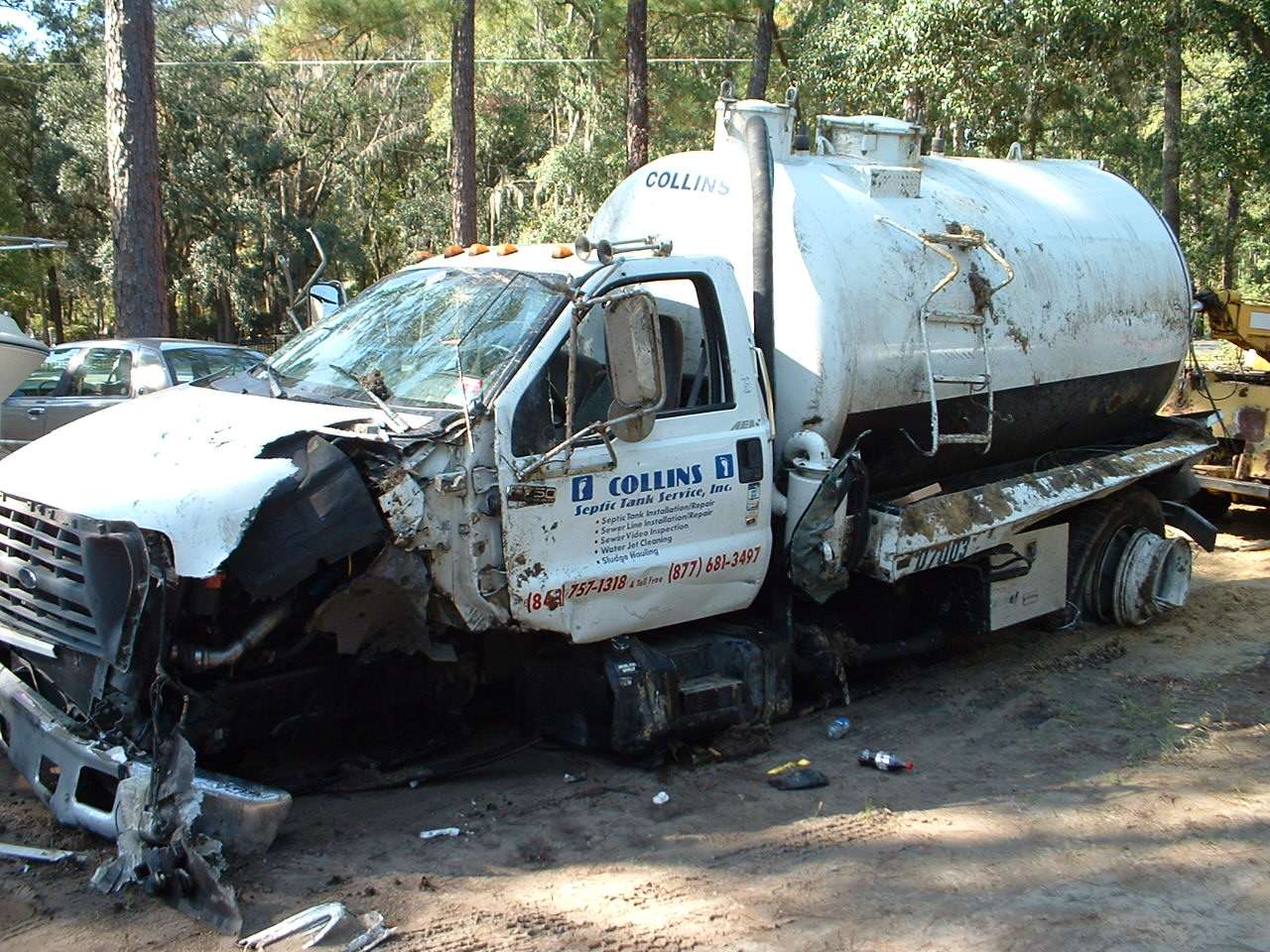

post-953-1163385606_thumb.jpgWell the whole reason I bought the Mack was Three weeks ago I was loaded comming off a Island doing about 40 in my 2001 ford f-750 with a 2500 gallon tank when a guy in a 97 ford explorer fell asleep at the wheel and hit me head on and I rolled the truck. They put us both in the same ambulance and I remember the EMT telling the guy he got the Sh?! knocked out of him. and the local news headline was"Overturned truck causes stink in the lowcountry" Nothing spilled so that was good. I like the :mack1: alot better.

WOW!!! You were lucky there. I think you'll fare even better in the Mack next time something like that happens. Not that I would put that on anyone.....
BTW...Nice rig!
Oh, I suppose you tell everyone that asks........."Ya, I had a crappy day" LOL!
