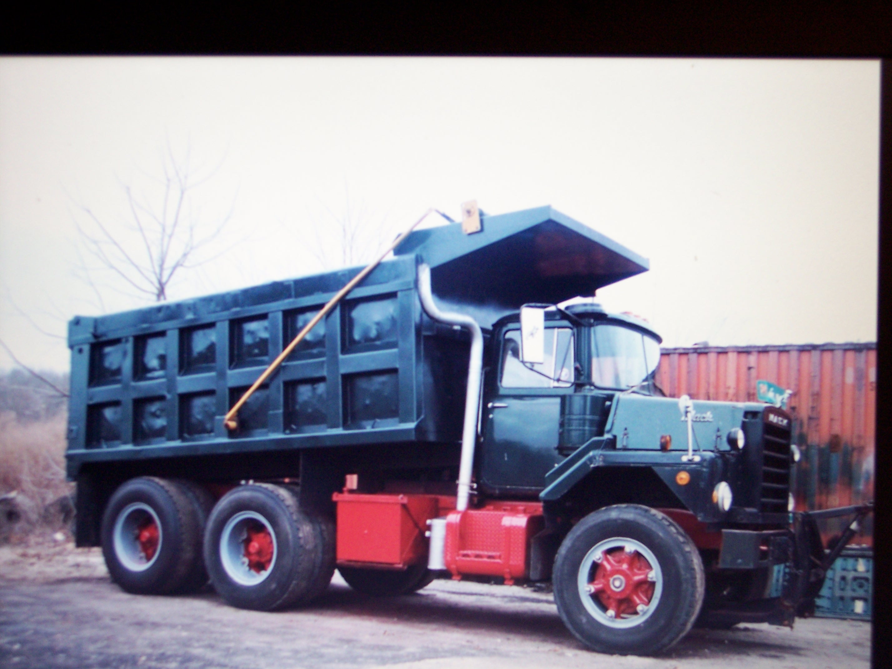

This old Mack was a tractor when I picked it up at an auction,I bought it with the intention of building a dump the thing is it had the right specs as most of the DM's had,there are plenty of tractors out there that can be converted into dumps but like everyone else said make sure you got the right specs for what ever your jobs are gona call for.Good Luck . post-598-127302336681_thumb.jpg
