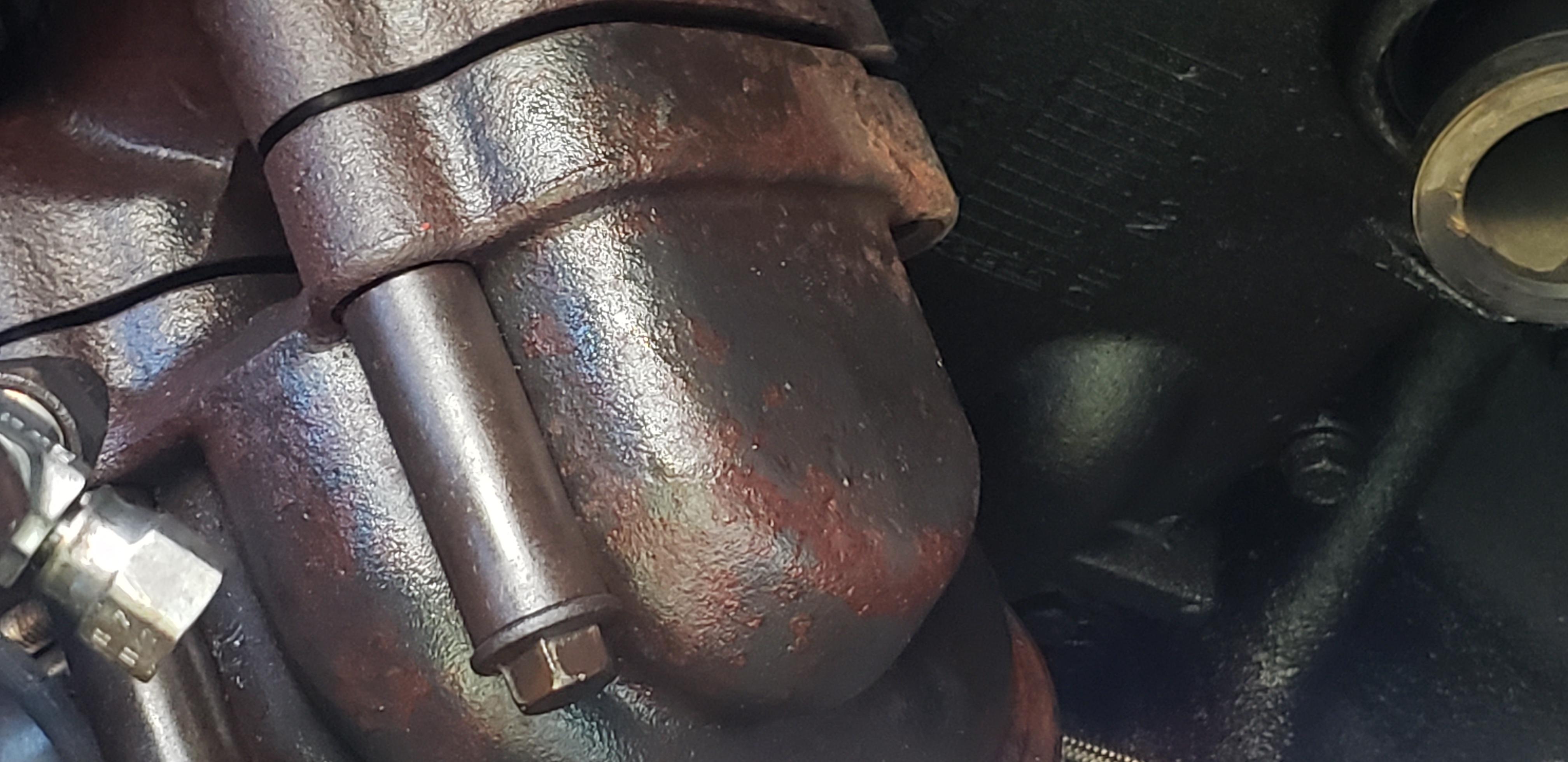

  4. Welp, you were right. I broke off the bottom egr bolt. I put the truck back together with three bolts and copper exhaust sealant and that didn't work at all. So I ran the truck a couple weeks trying to recoup some money first but its going to the dealer. I'm not gonna break anyone bolts myself. Especially the ones going into the head.
  5. So I broke a bolt off the manifold bolt that holds the egr onto the manifold. I couldn't get it out so I'm letting the dealership handle the replacement because I think the actual bolts holding it to the cylinder head would likely break off too. What do you guys think? They also claim that the three piece manifold has to be replaced together because the new single piece probably won't fit into the other existing pieces. The third one (last- egr mount) manifold is the one that's screwed up. $3,600 is the quote for the exhaust manifold to the completely replaced.
  6. And it would probably be a good idea to replace it instead of sealing it up? Oil temp does see 240⁰ climbing mountains. My truck is a 2011 so I would guess it should be the newer style already?

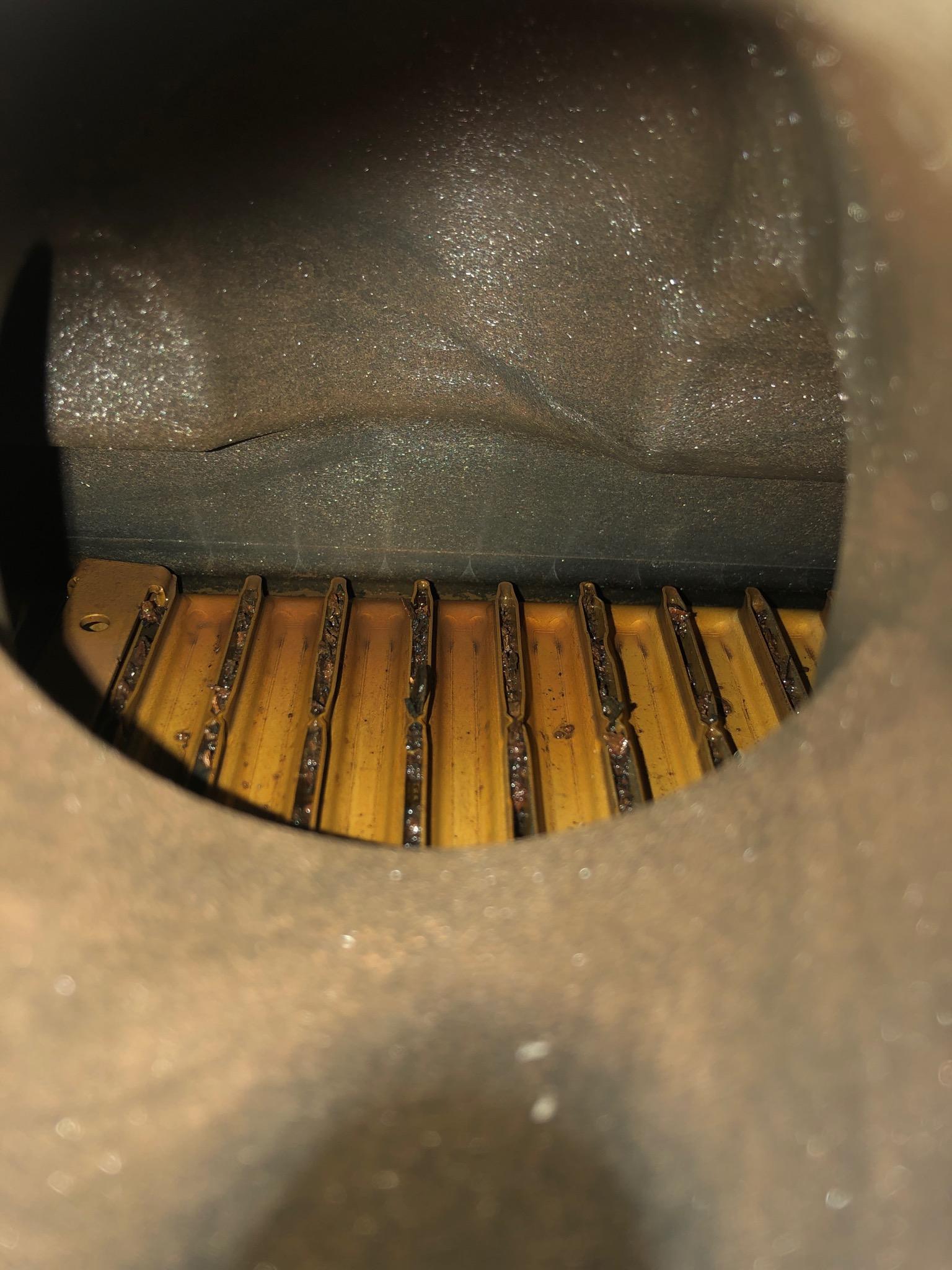

  10. Looks like it was a plugged radiator. Tuesday we hooked a loaded trailer to the truck and a tech rode along with a laptop to check the coolant and oil temp, as well as the fan on-off command and percentage speed of the fan. All of that was working right but still had higher temps going over the bridge. So we all finally agreed to change the radiator and see if that was the problem. Looks to me like it's almost completely plugged up. They should be done with it today.

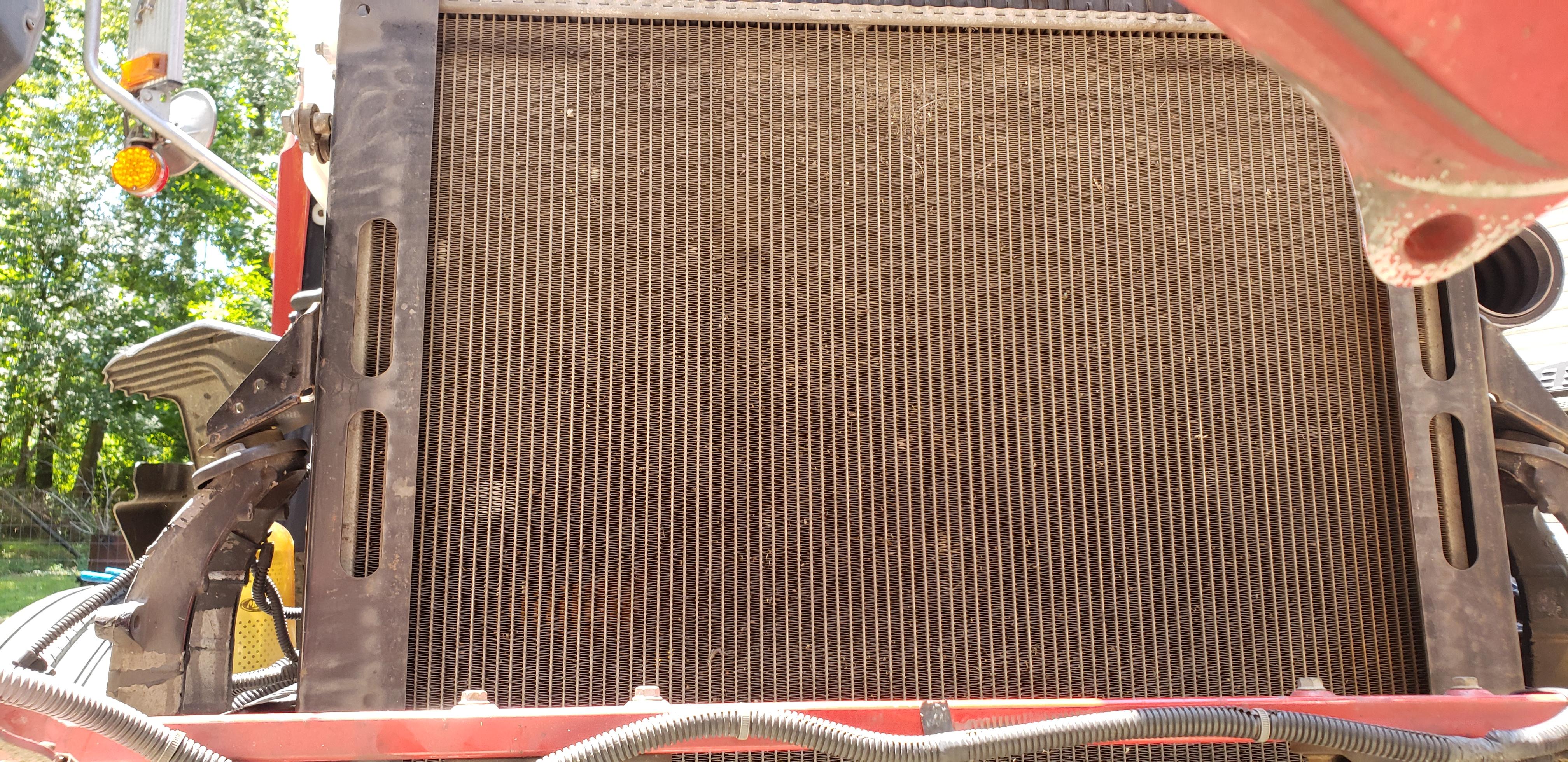

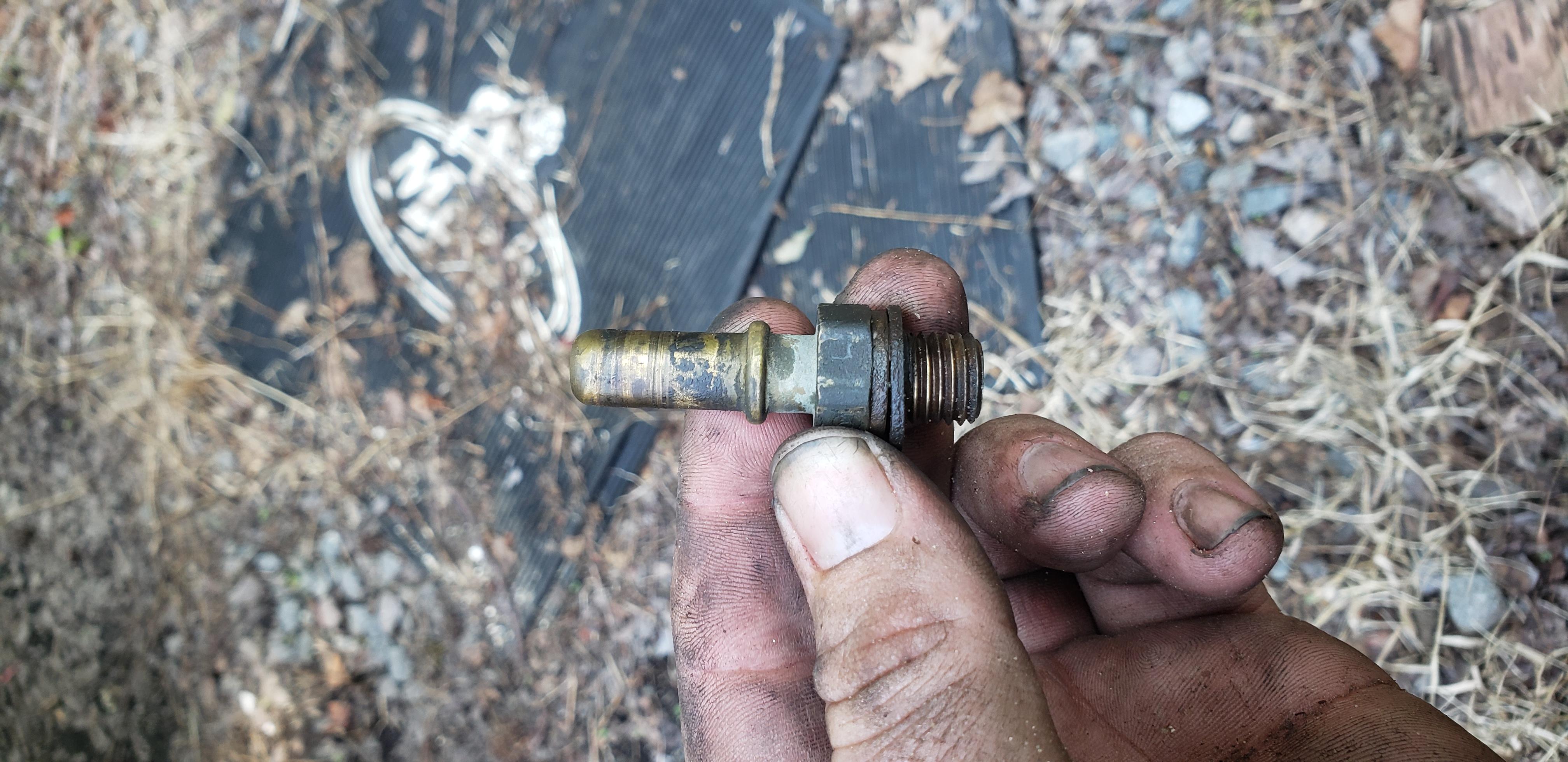

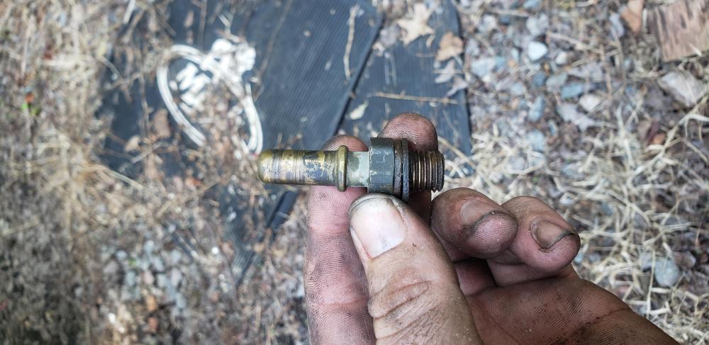

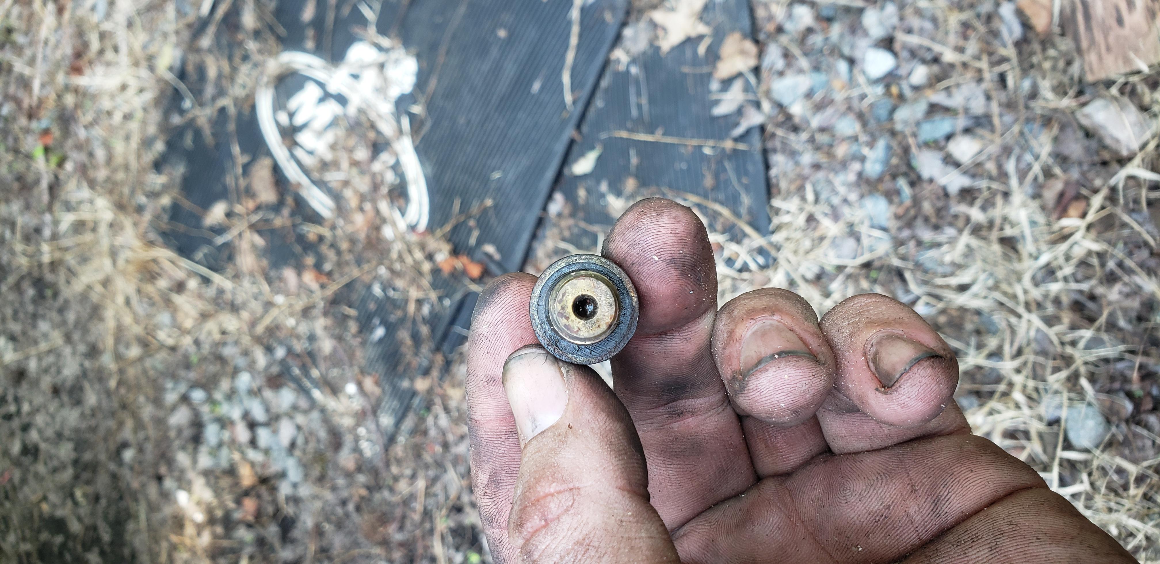

  23. Well guys, looks like I may have found the issue, and I found by a freak accident. I broke a quick connect fitting off while trying to use several extensions to remove the fan belt (bad place for it) and broke the plastic tab off inside the hose. The hose I think goes to the DEF doser or the return from it. Anyways, coolant was only coming from the doser and not from the engine side and I thought maybe it's a check valve, but the brass fittings for the connector is plugged solid. Do you think this could be reason enough for running warm on flat ground and overheating 3/4 ro the top of the mountains? As far as the radiator goes, I took the CAC off (heavy bastard too, thanks for that warning ) and it's pretty clean, few bugs but looks normal. I'll wash it since I've done the work but I'm changing the pump and thermostat now anyways because I'm halfway apart now. Main thought is all this is because of the brass being plugged up?
