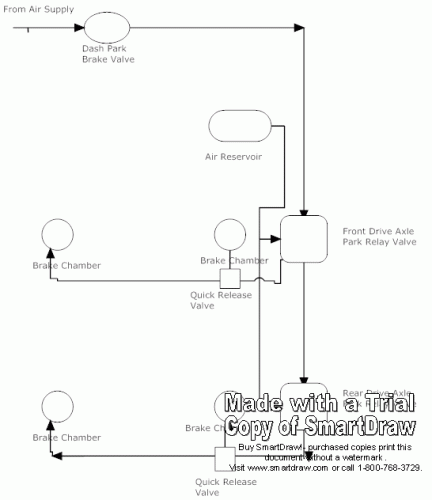

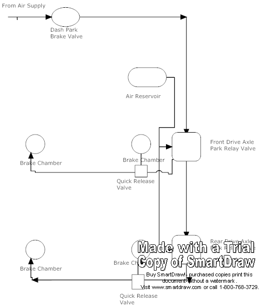

One thing you should do if it's not already there is fit relay valves to the spring brake circuit. This allows faster actuating and release of the spring side of the chambers. When I restored my White 4000, I even put QR valves in the lines to ensure they actuated quickly. Nothing worse than thinking your park brake is on only to realise your still rolling a little. I have done a quick schematic of how you should plumb it all up if that's any help. I can't say what prices are like over in the US, but here in Australia 30/30 brake chambers are around $65 new each, relay valves about $120 and quick release valves about $25.
