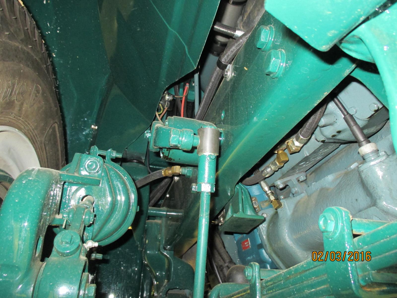

Hello All, This is my first post on this site. I have a 1962 B67. I would like to know how to remove the rod from the houdaille shock that runs to the axle mount. Do they pop off or do I need to remove the ball stud? If so will a pickle fork work or a tie rod tool? I would be thankful for any help. TomVb.
post-22511-0-65268300-1454895259_thumb.j
Remove the nut that holds the ball and stud to the shock arm. The link comes off as a complete assembly.
I want to thank all of you for your help. I took all of them apart today with no problem!! I must tell all of you the picture is an example of the rod from another Mack and not mine. If my truck looked this good I wouldn't be asking any questions on how to take it apart. The B67 in the picture is fully restored. I am just starting on mine. Again, Thank you. TomVb.
Did the earlier Bs have threaded plugs?
Some of the early link ball ends for big vehicles had a cup and spring to take up play and to account for ball and socket wear. Stopped that set up about 1954 or 1955. Cheaper to make what is in the photo.
