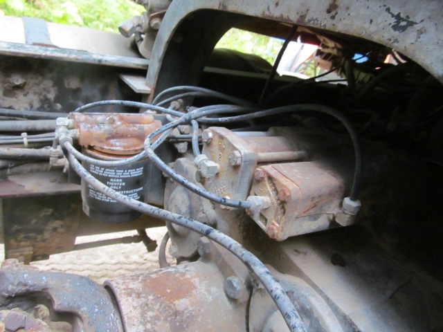

Reverse is becoming more troublesome to engage lately on my RS600. I have a 12 speed with the air selector reverse. Im having to try far too hard to get it to engage reverse. I'll inch it around in forward gears a bunch, in and out of the clutch and other range selections until finally it will grab reverse. I don't hear any air leaks. So where can I start looking for an issue, I have just ordered a new air line filter, Mack# 2MD3131. After that, im lost. I have attached a picture of the air solenoids/valves on top of the tranny. Which one activates reverse? Does anyone have any tips in engaging reverse?

The round cylinder on the driver side is the direct/lo cylinder. The square one on the passenger side is the neutral/reverse cylinder. The air fitting on the side of the neutral/reverse (passenger side) is the reverse supply air line. You could remove the airline from the reverse cylinder and select neutral/reverse and see if the supply is quick or slow. If the air supply seems ok, you may need to remove the top cover and replace all the orings in the top cover shift cylinders. It looks like you have plenty of space above the top cover to remove it. There is a oring kit that comes with all the rear top cover orings. Also replace your little circle stone breather thats on the bottom of the direct/lo cylinder (round cylinder on driver side)
If the air supply is slow or intermittent, you could have a bad inversion valve or shifter. The airline from the reverse fitting runs back to the inversion valve.
Alot of problems with air selection are the top cover orings.

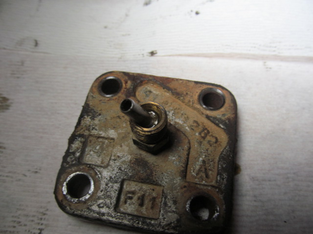

Ok so im finally getting around to working on it. Pulled the top cover off no problem, lots of room. I noticed that on the reverse cylinder, the air fitting on the square top cover is loose. I have attached a picture of it. I can wiggle it to the point where it will come right out. Could this have been my issue all along? I understand that this is not the supply line for reverse but still wondering. I could not hear air escaping at any time however. If this is a problem, does anyone have the part number for these fittings? I suppose it may snug up with the line attached; but thought id ask anyways.

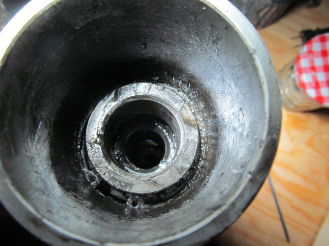

And I started on the hi-lo cylinder and im REALLY struggling with this internal snap ring. I have attached a picture of it also. I had to leave it for today due to frustration. Are there any tricks for that one? Im feeling like I want to leave the remainder of that cylinder alone as the hi lo was working fine. I have neatly placed all parts that I have removed, in order on a clean table but im not yet seeing all of the o-rings that I got in the kit. They must be down deeper in the hi-lo cylinder im guessing. And am I safe to use brakeclean to clean everything up in there? ...if all the orings are getting replaced that is..
