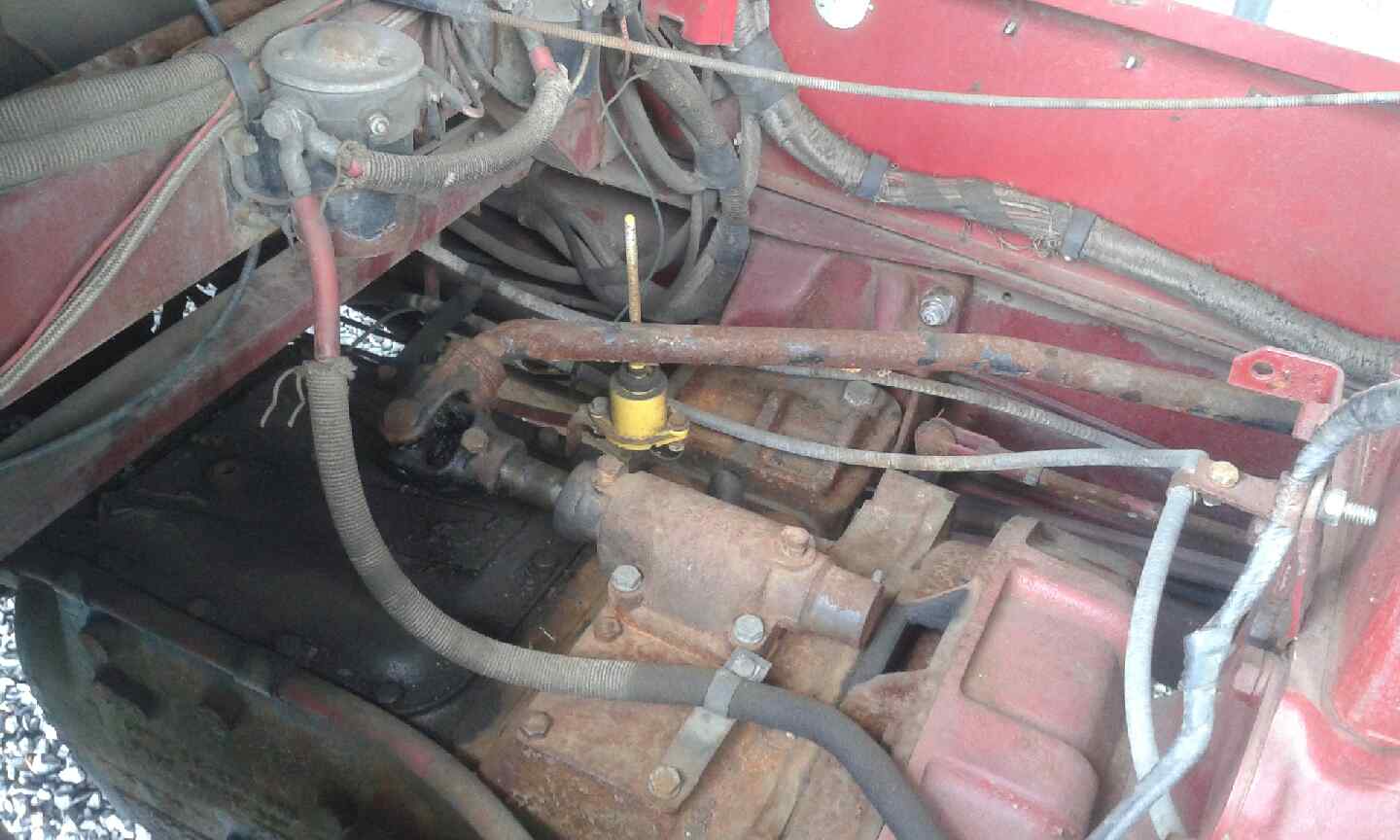

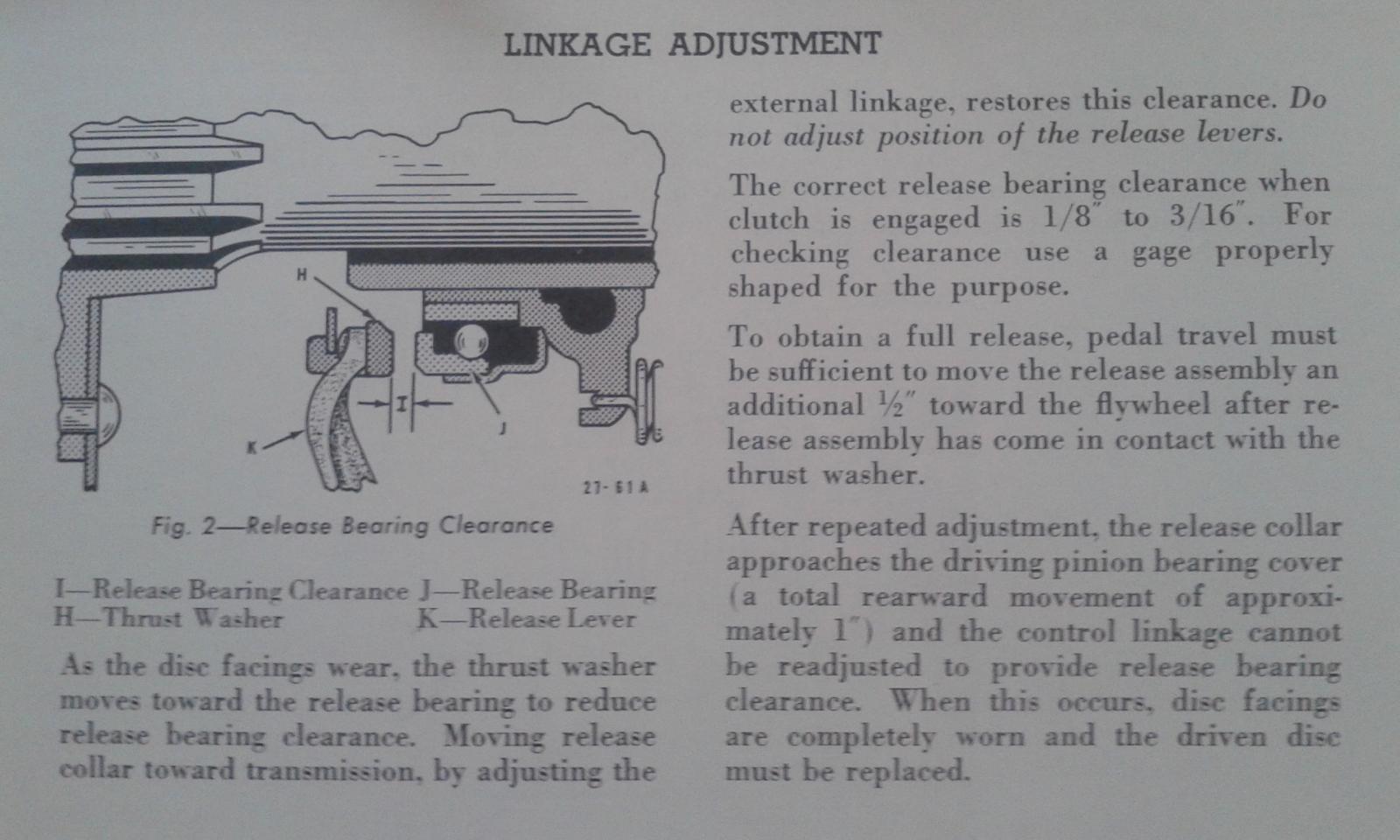

I'm looking for somebody to point me in the right direction/give some advice for trying to adjust the clutch on my C85. It's just started occasionally slipping while under load in 4th and 5th gear, and I'm hoping an adjustment will help, as opposed to replacing/rebuilding. I looked over the manual for the truck, but had some trouble wrapping my head around what it was saying; maybe because that was before my daily cups of coffee? :whistling:
Have you had a chance to look inside to see what sort of gap you have right now?
I haven't gotten that far into it quite yet, will hopefully be able to look into it in the next few days
How much freeplay in the pedal? Does the clutch engage at the top of the travel?
I haven't paid all too close attention to that, but now that you mention it, it does seem to be more towards the top when it engages. The thing I've noticed is, when I first bought it back in February, there was no slippage at all, and the more I've driven it, it seems to have developed- could it be that the linkage has worked itself loose from lack of use, and now being used more since I bought it?

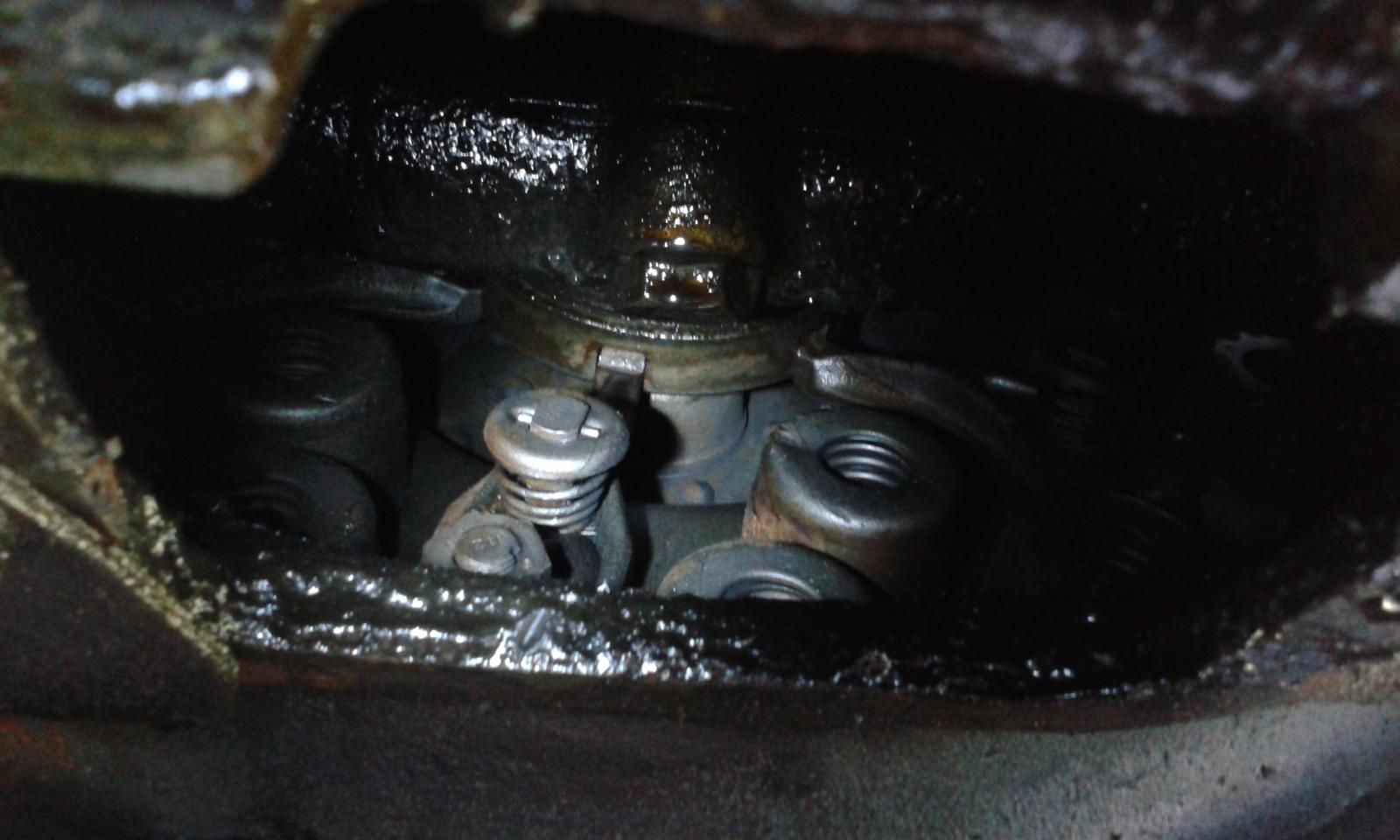

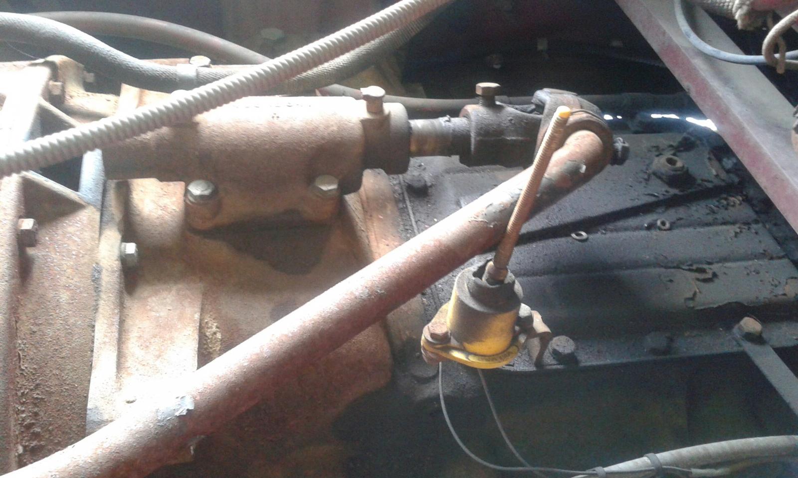

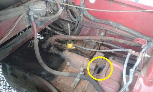

Looks like a lot of oil. None on the disk is there?
Yeah.....Lotta oil in there. Keep the thought of a blown rear main seal in the back of your mind. Check the pad thickness- if it's pretty worn, between that and the oil, you can adjust that thing all you want but it'll keep slipping, You may have to drop the clutch and send it out for a rebuild. Aaaaaand since you have the tranny and clutch down, you may as well drop the pan and roll a new rear main seal in there. If you do wind up dropping the clutch and tranny, don't forget to check the flywheel surface and get that machined if necessary.

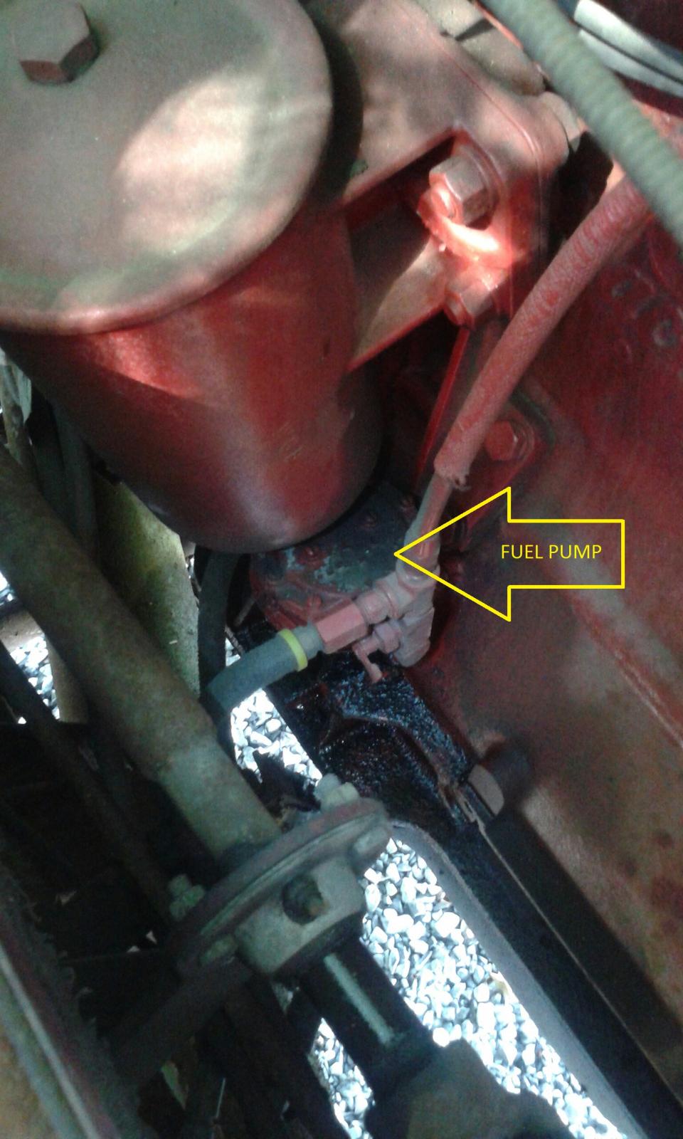

After investigating things a little more today, I think I've narrowed down the problem. There appears to be oil leaking from behind the fuel pump, where it connects to the side of the engine, which extends back along the side and underside of the engine and transmission. The closer to the fuel pump you get, the more fresh and thick the oil is. The rig had sat without being run for about a year before I bought it, so my best guess (and based on you guys' suggestions) is that the gasket between the fuel pump and engine went bad, and the more I drove it, the more oil pushed out and began getting into the clutch, eventually causing the slippage. My question now is, how should I go about trying to clean the oil off the parts in the clutch? Thoughts/suggestions?

Generally once the clutch has oil contamination it's toast. Slipping generates heat and can cause problems with flywheel and pressure plate surfaces. You can remove it and "try" to cook it out with a torch (rarely really works more than 50% of the time), clean and scuff the flywheel and pressure plate.
I'd fix the leak(s) rebuild the clutch assembly, check the rear seal on G.P. and start fresh. Less trouble in the long run and less labor in the end. Paul
I agree; once it is oil coated it is pretty hard to get the clutch disc to work correctly again. But, you could try the obvious since the adage of "nothing to lose by trying" applies here. Use brake cleaner very liberally and let it run off, spin the engine a 1/4 turn and do it again, when it is as clean as you can get it do it again while the clutch pedal is depressed. Spin the engine a 1/4 turn, spray again, etc. I doubt it will work, but it is a lot easier and cheaper than pulling the engine or tranny to re-build the clutch.
If it comes down to a re-build I would seriously consider pulling the engine in lieu of removing the tranny so you can replace all of the oil sealing gaskets and properly clean and paint it. It will take a serious lift, so you may want to get a shop to do it if you don't have a big hoist or fork truck.
