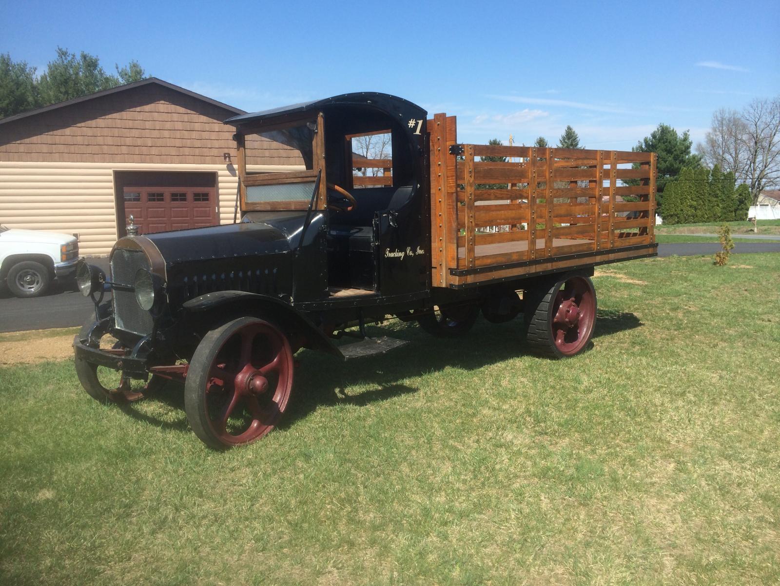

The guy I bought it from had the build sheet says it was ordered with headlights and no generator but a battery. It was ordered by Texaco. He couldn't find the info though. I'll have to measure them. Mike

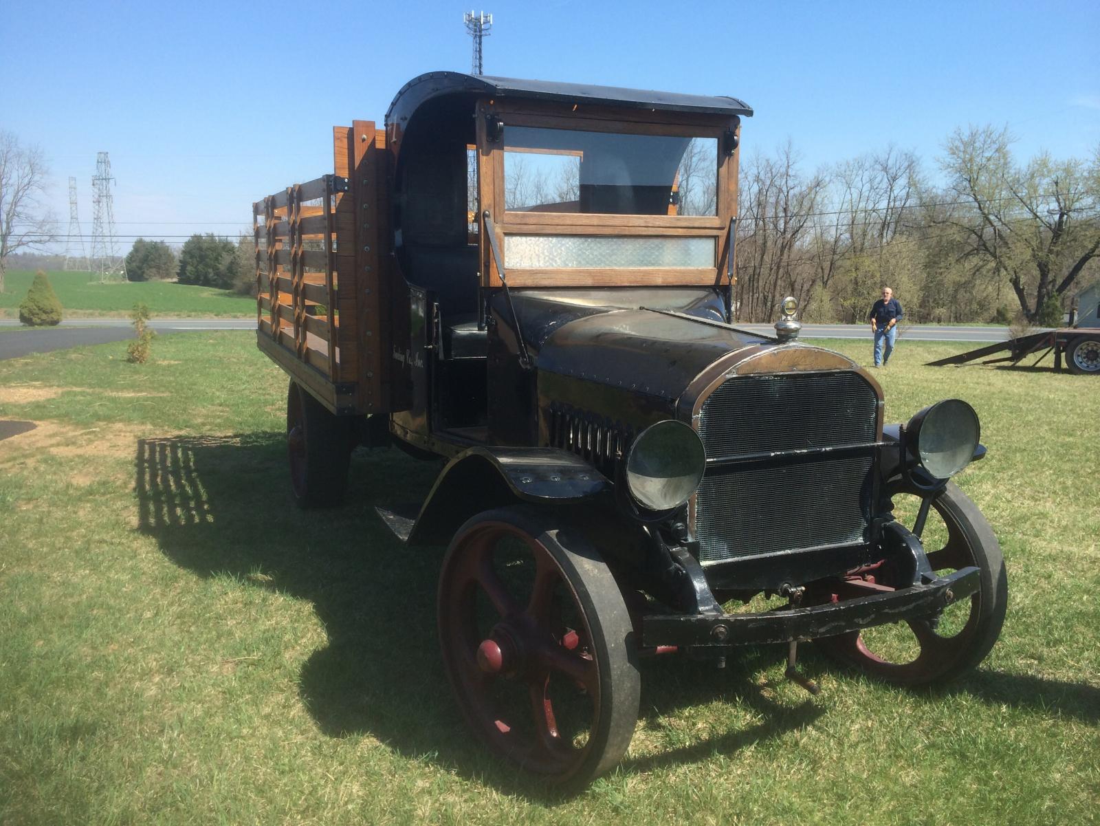

Nice truck. The headlights look to be adlake electric headlights. I have some just like it on another truck. 1922 was the year the bell shape or hood shape plates started to be used. The radiator is the early style, which I believe was not being used at that date. Are you sure it is a 1922?
I don't have the information from the Mack Museum. The previous owner had gotten it, but could not find it when I picked up the truck. I guess I will have to request it. I assume he confirmed the year with the information from the Museum, but I do not know. The truck could have been pieced together or had pieces replaced in the last 93 years, but the serial number on the frame matches the plate. I guess I need to search for adlake electric headlights. I will also measure them and post the size. Thanks, Mike

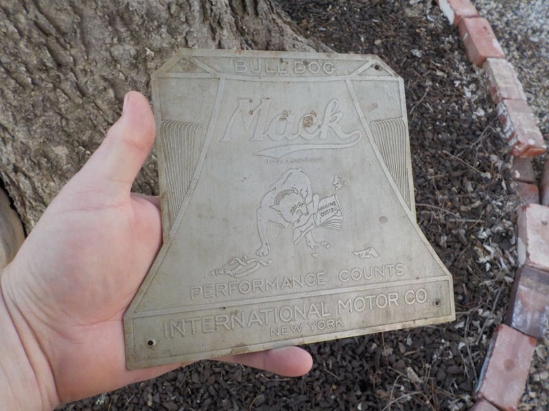

The hand is taken from ebay. The guy wanted $550 for the plaque. I should have bought the one for $120 earlier in the year, but I didn't know I would need one then.

The plaques appear to be identical to all but one of my AC's.

The year probably is correct at 1922. AB Macks had the small radiator until the 1923 model year, when they switched to the bigger radiators, different fenders and longer running boards as well as larger rolled steel bumpers. Everything on your truck you have is pre-23. the bumper is smaller and made of rolled channel iron, the short running boards, the angle iron fenders (90 degree from top of fender) instead of flared fenders (aprox 60 degree from top). There are a small number of 1923 models that have the bigger rolled steel bumpers, bigger radiators but still have the 90 degree angel iron fenders and short running boards.

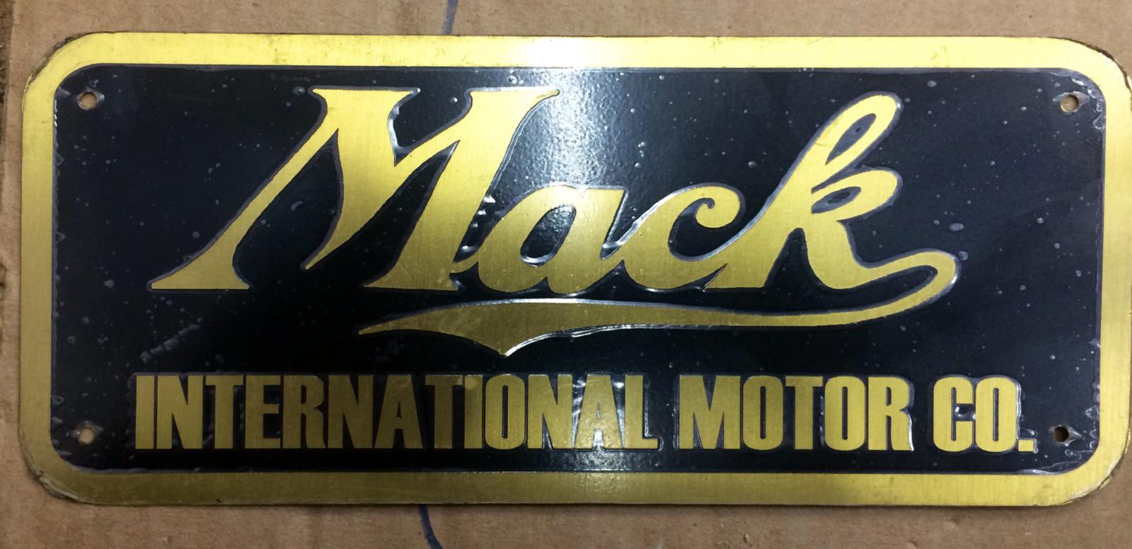

I think a '22 would need the brass cab tags that just said " Mack ",I gave up looking and had my vinyl sign guy make me a set for my AC I've got the measurements and a good scan from the museum if you want to go that route .

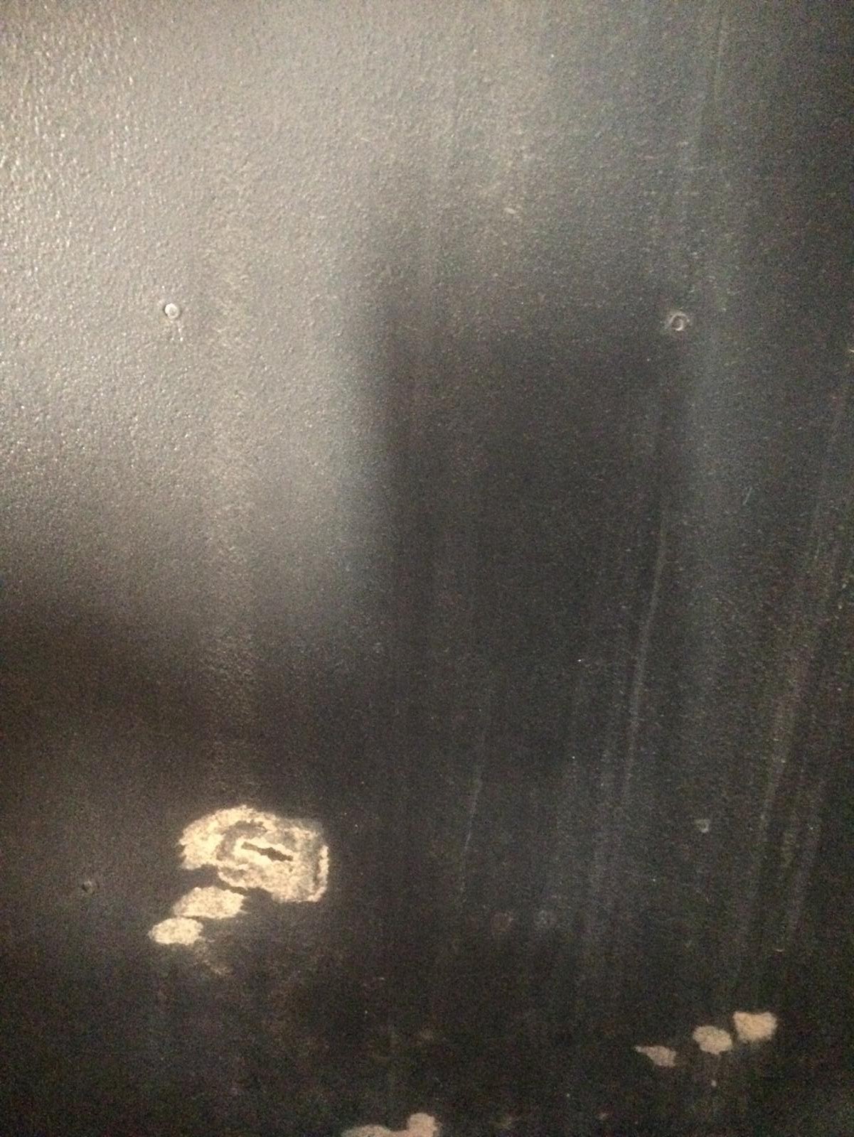

Thanks, Mike. I can see filled holes on the inside that look right for the larger plaque like this one.
Mike is correct the pre 1923 models, they have the smaller plaques just saying Mack, Ill post a pic, tomorrow for you. 1923 was the year all the changes were made on the ABs. Nice truck saw it in the wheel of times for sale and called but it was gone already, glad to see you got it!
Not to jump the gun. Is this the plaque in the photo? Are the AB and AC rectangular plaques different? I am going to need a pair down the road. I could use a good tracing to have a company called Tom's Model Works photo-etch them from brass. Seems the AC's went to the "Hood Plaque" about 1919 same time they dropped the round radiator. Paul

Paul I can get u a copy of both (tracing) the tall or the short one for you. Depending on the year of your truck determines which it is. Also can get you a copy of the plaques on the inside of the cab., the only differences on the larger plaques that i noticed is where the truck came from. Either they say New York or Alllentown on the bottom

Here is the correct Mack Plaque for the 1922 AB
