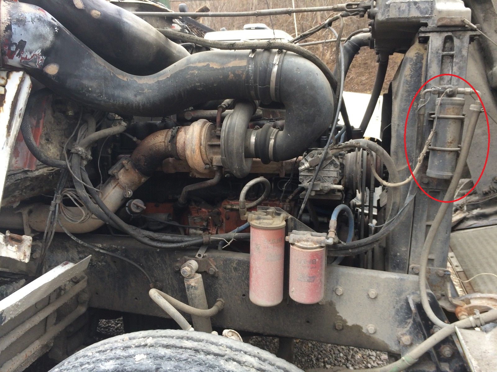

Also, can you tell me what the object marked in this picture is? I'm guessing it must be something to do with AC.
Thank you.
