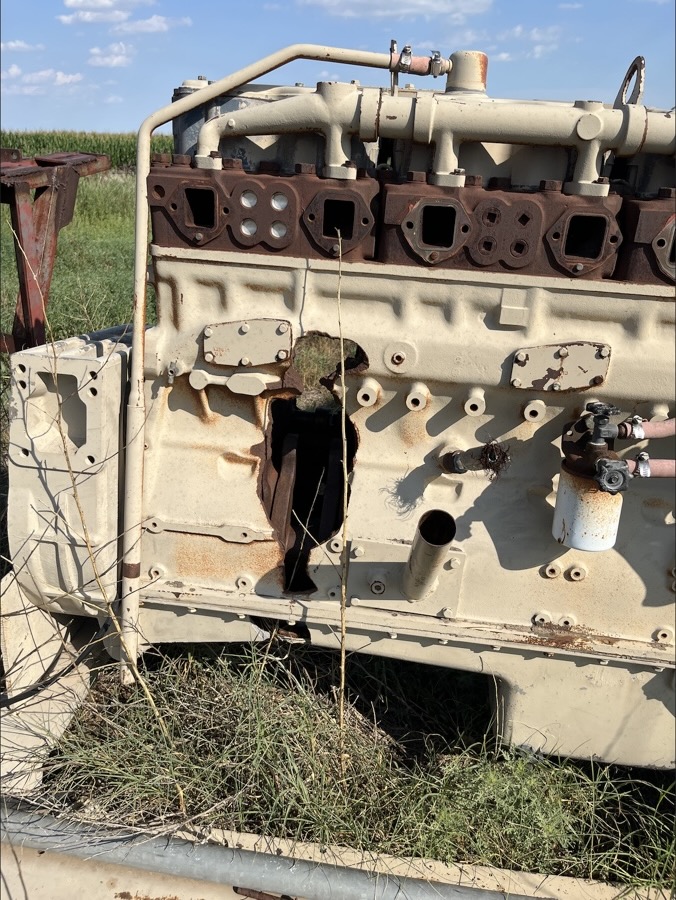

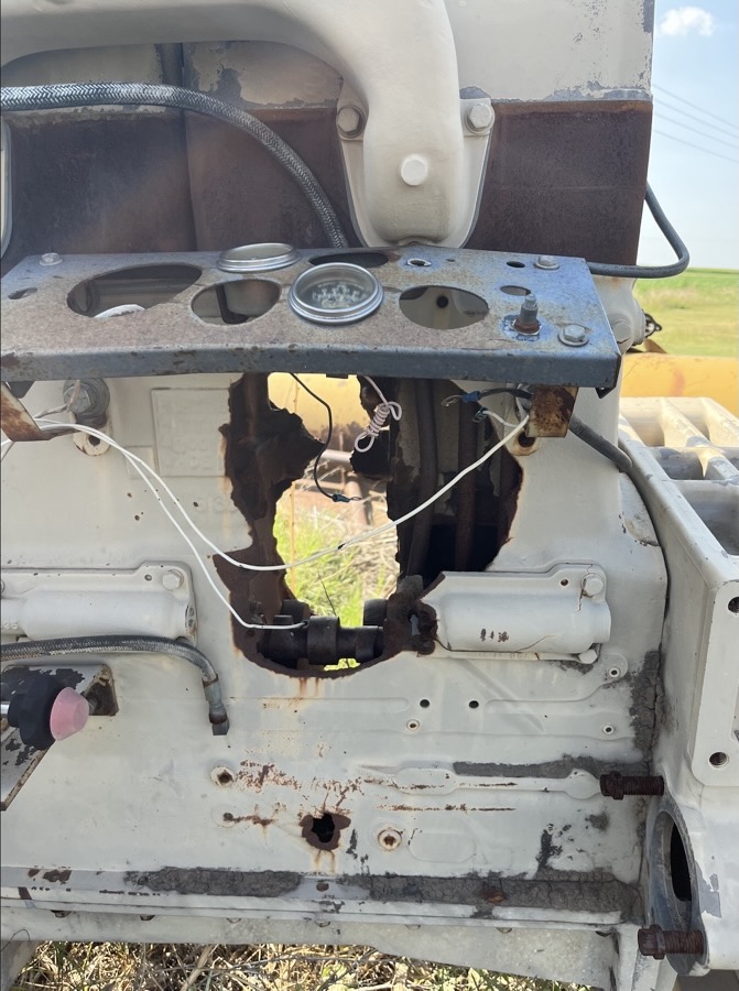

Only getting 250-300K out of a 237,what kind of abuse and neglect were they seeing?I've seen many go 500-700K and at times nearly a mil without an overhaul!CATS were a true high miler also.Cumaparts while a good engine had nowhere near the longevity.
745F9D9E-2565-47EA-B18A-52A0067609CF_1_201_a.thumb.jpeg.f1f2c3fa9b810bc0a956769fb63447d9.jpeg059F05B3-CD70-413E-8E6E-DB3A0B51E2B0_1_201_a.thumb.jpeg.bd5f62419ee617a19c345a3445caa0cf.jpeg
Cumaparts you call them huh? Well the Big Cam at least looks ok
