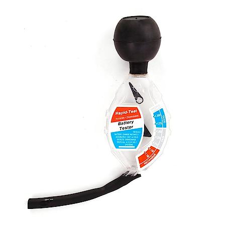

Check the cables, particularly the ground and use a Hydrometer to check for a weak or dead cell or cells. You can get an inexpensive one at Tractor Supply. Napa or even Wal Mart.

Charge them up with them off the concrete and let them stabilize for an hour or 2 (it allows the surface charge to dissipate) and check each cell with a hydrometer. That will give you an answer to the cells being good, weak or bad. Good test, goes back about 100 years an still accurate.
