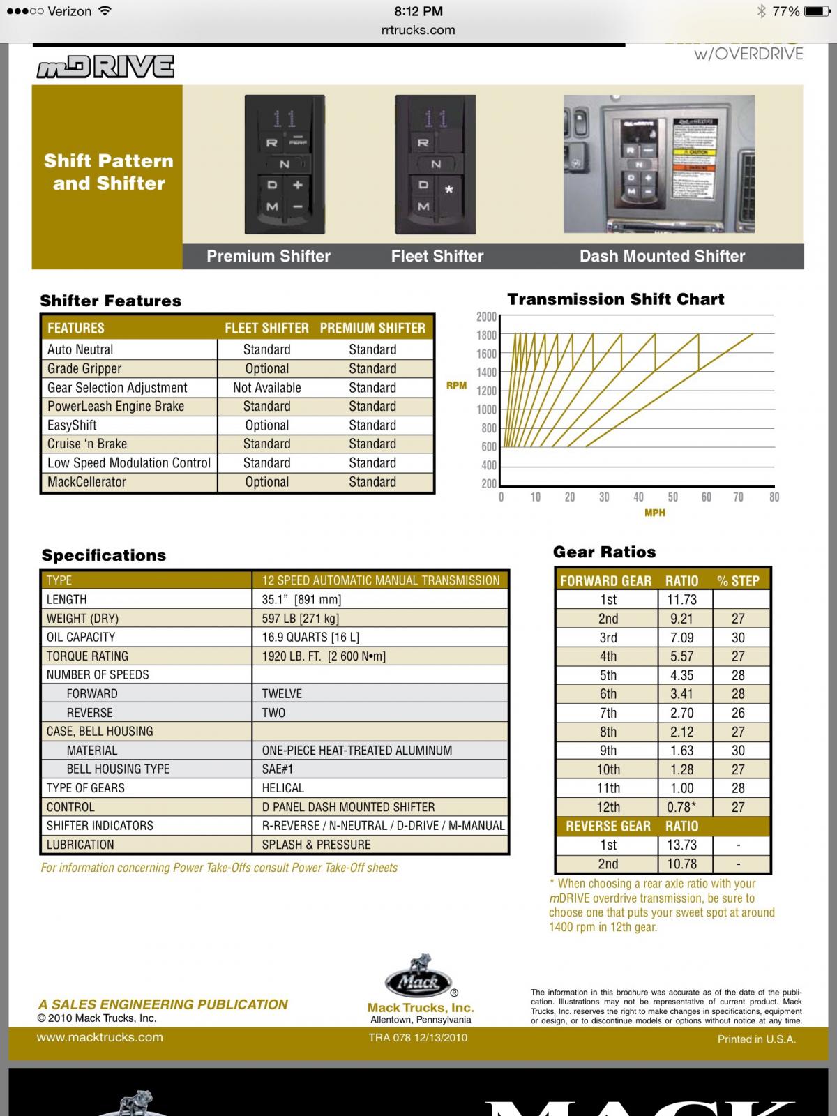

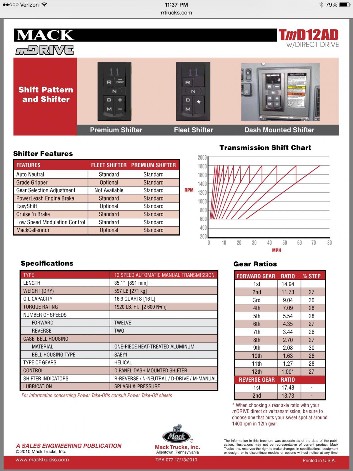

I'm cleaning up specs on new truck for dealer.I run midwest to southeast.62mph,dry van drop and hook,30% of loads are 79500#.Looking at 445hp with M-Drive.Would like to get 8mpg but 7.5 would be ok.3 gearings have been mentioned,2:66 with single o.d.,2:66 direct,3:08 with single o.d..Tyson driver is running 2:66 direct and getting 8mpg at 65mph.When I talked to him he was at 1550rpm's.That must be around 65 to 68mph.
Well you get more rear wheel torque with direct drive, any overdrive reduces rear wheel torque and so therefore you have a shot of best mpg with direct but the higher gears are easier to damage and you lose bottom end takeoff. Running near gross you will appreciate the lower 1st gear with an overdrive transmission and its unlikely youll ever notice much difference in mileage out of a controlled test setting. If you were running closer to 40,000-50,000# all the time a higher low wont matter as much so the direct would give you decent service. If your not set on the M Drive and want to get the best of both worlds go with a Mack 318LR or 313LR, or even an Eaton 18 speed transmission there youll get a lower low gear to get you moving near gross so you can still run the higher rear gears and when you pop it into OD your gonna really drop rpm. Have you decided against the super econodyne option? Mack has alreay done the homework if you go with the Super Econodyne Pinnacle and you should get the best possible mpg with that set up.

Tire size will be 295/75 22.5.From your post it looks like direct will do the job.I think the M-Drive has a lower ratio on 1st gear.

I just bought a '12 with 445 and M drive direct with 2.64. It's not a bad Trans, but wish I held put for the Allison. It does not shift as smooth and pulling the tank I notice. And it's hard to get use to the shift points. Though others I talk to love the TRANS. I'll have to wait and see how I like it pulling the dump and belt trailer.
Eaton 18 speed is 14.40 low, .73 OD, Mack 318LR 16.42low, .71od.
Eaton 18 speed is 14.40 low, .73 OD, Mack 318LR 16.42low, .71od. I'm not gonna tell somebody not to get an auto, however a clutched auto shift is not the smoothest at low speeds and off road and remember that with an M drive/I shift there is a 0 shaft endplay measurement so they pretty much can't be repaired they always have to be replaced.

I am still working on this. I'm stuck with 2:64 single o.d. vs 2:64 direct.I talked to a Tyson driver that said he was getting 8mpg.He thought it was a direct because he passed me at 65 to 68mph and tach was at 1550rpm.He runs heavy,80000#.I would like to know how Tyson specs there Macks.I run 62 to 65 mph at 79000 95% of time I may be running 25000# in future.If Freightliner is using 2:50 12spd direct,how would the 2:54 m-drive do?
We have been over this before a few times....have we not???? Just keep in mind the faster the rear end/direct drive trans combo, the more torque you are putting on the drive line and rear end.
