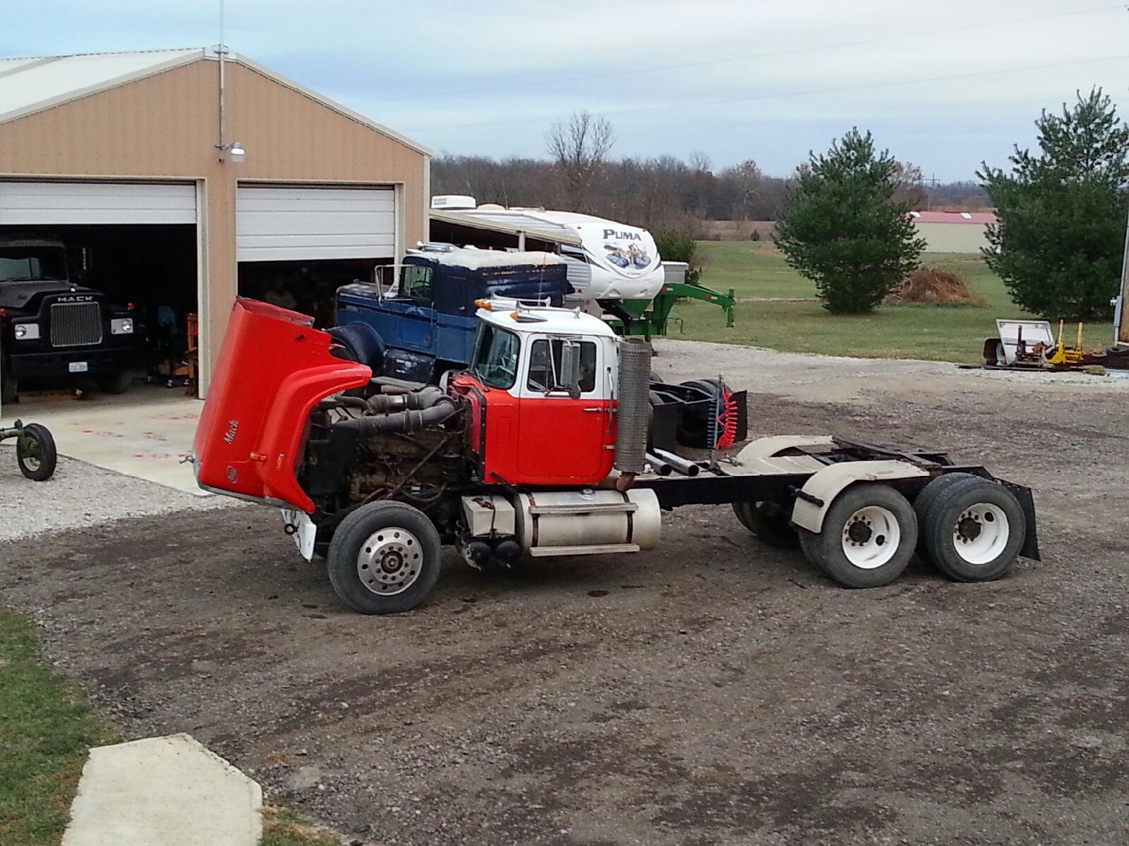

Found a new pup a 1978 Superliner
Looks Good!
Uh oh. The garage is starting to look a little small for the fleet.
Next project is more insulation than expansion of the shop-ma-haul right now I can get everything inside but the F but I a jd 3020 to restore this year so the KW is setting out but I have it listed for sale

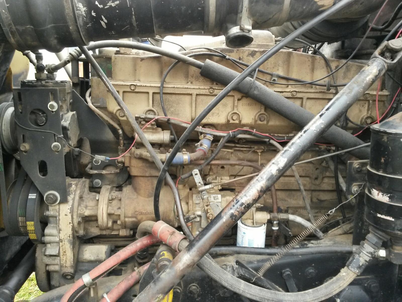

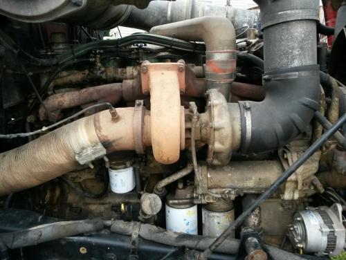

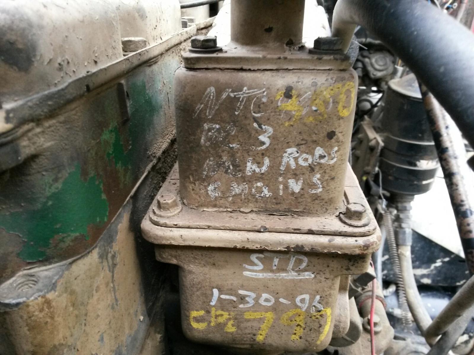

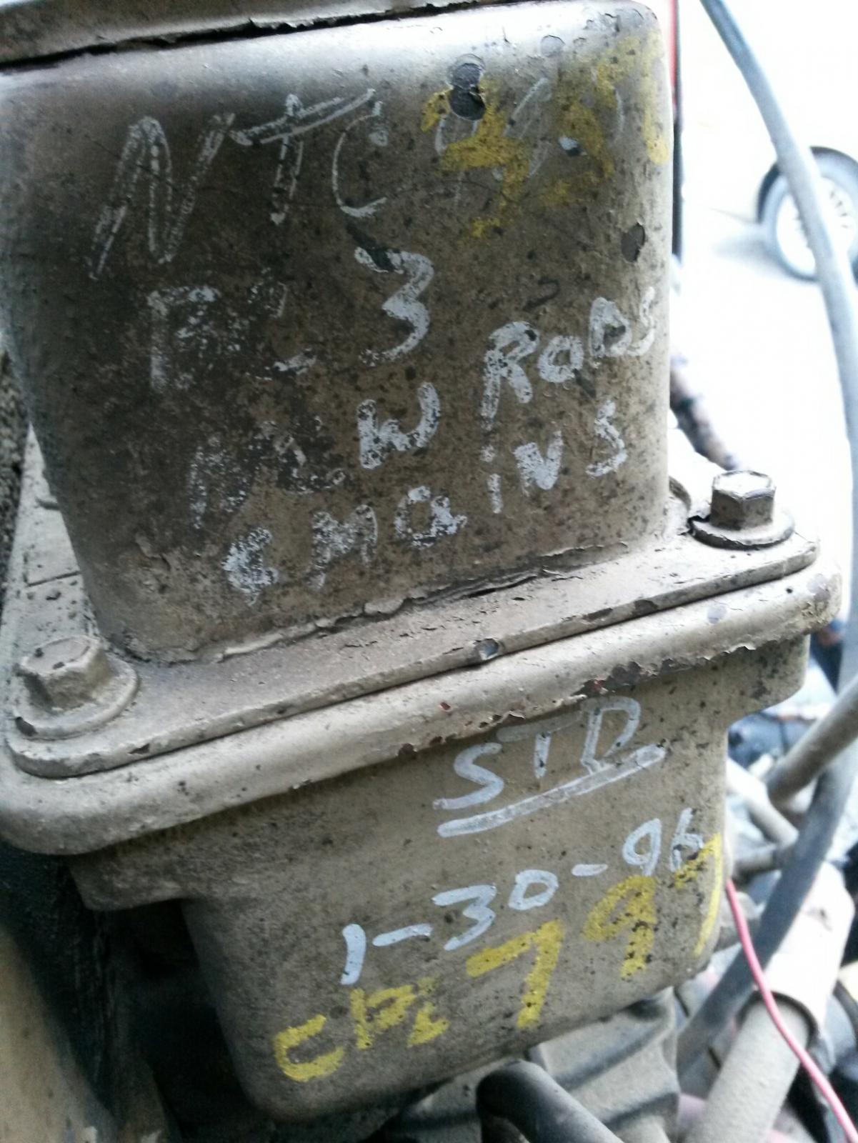

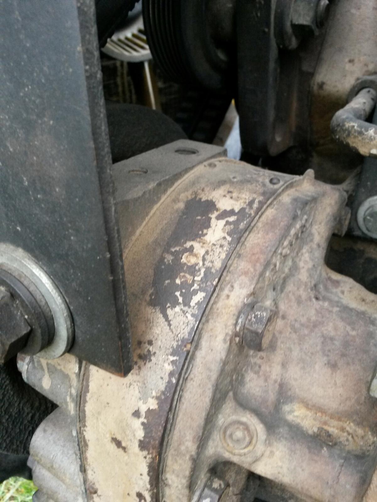

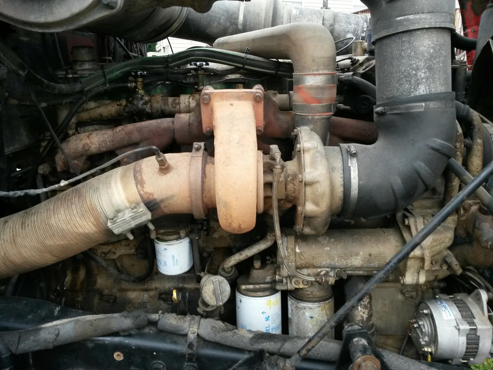

Anyone know where the engine stamp sn# on a cummins is located when the data plate is missing? Was on ebay looking for a service manual went out to the truck and popped the hood and the data plate is missing climbed on it for a fewminutes and found this.
I think the wiki is wrong it says by truck SN (RWL766LST39600) it should be a NTA 400 ISC but from what I can find on the interweb that ISC engine never came out until mid 80's and the pictures of an NTA 400 I could find online don't match the one in the truck. Of course I understand that the engine may have been swapped but waiting on the Mack Museum for verification from the build sheet, that aside want to start getting some manuals ordered so I can start poking around on her before body work.

Here is side shots

Congratulations on the new truck and good luck with it! Great pics also - could you please post more photos of the engine compartment? They would help me a lot with my model (although the build is on hold for now). Thanks in advance and have a nice day
Here is side shots
There is alot of mis information on wiki. The right engine is a NTC400,although I would think being a '78 it would be a big cam 1 or 2. I'm not up on all the Cummins CPL numbers,the engine in my '86 is a Big Cam 4 CPL676.
