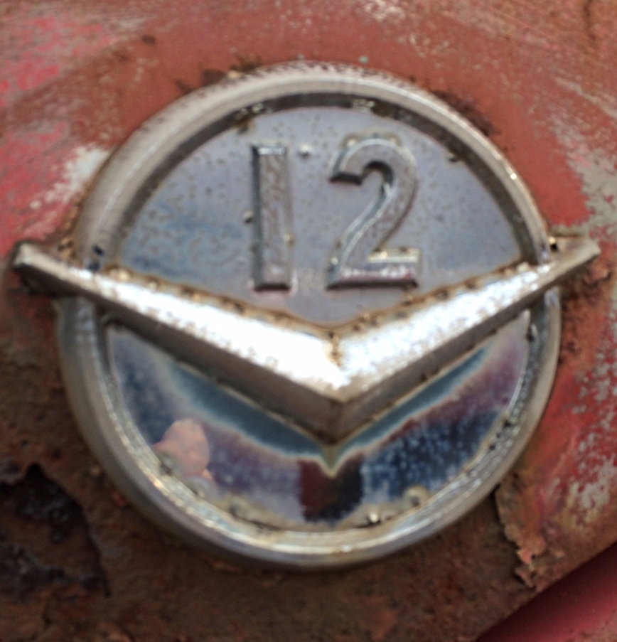

Originally they came with a pair of Rochester 2 barrels. That engine had an intake adapter to run on LNG. The piece in the back is the drive and advance adapter for the pair of 6 Cylinder distributors. Made in stock form about 250 275 h.p. @ 2400 rpm and 585 or 630 pounds of torque @ 1600 rpm. weighs in at a tad over 1500 pounds. Thunder V-12 makes a high performance Twin Six Magnum 956 cubes 500 plus h.p 735 pounds of torque @ 5000 rpm to the tune of $10,000 starting with your engine.
