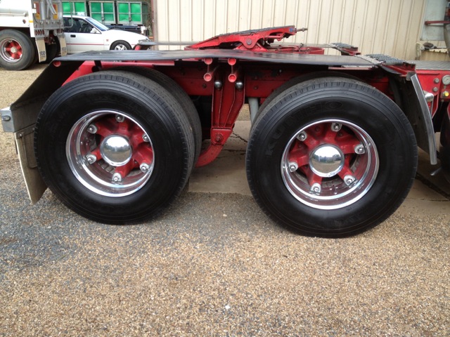

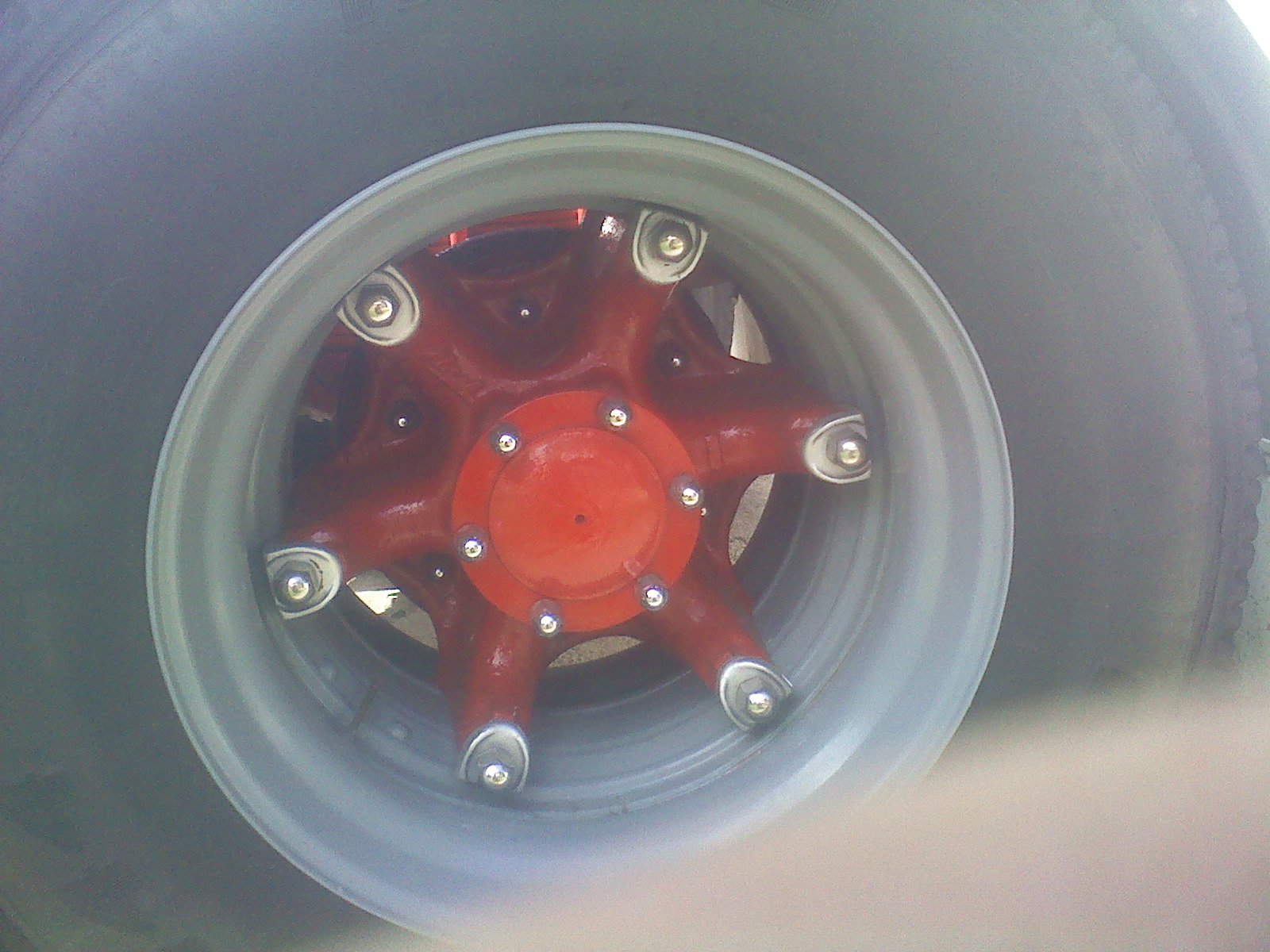

I'd like to see some pictures of Dayton spokes decked out with chrome lug nut covers. Red spokes with a white rim would be a plus.
And if anyone could tip me off as to what size the lug nuts are I'd appreciate it. I'm going to be ordering lug nut caps soon but I always forget to measure the nuts when I'm at work.
