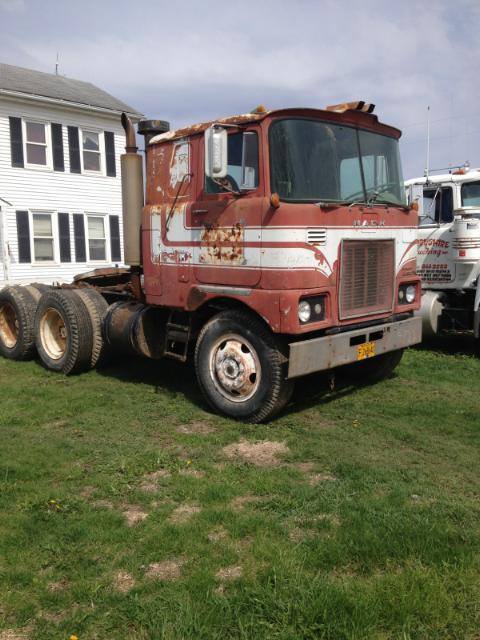

Your "F" model is an early one, steel dash- torsion bar cab.
The doors are basically the same, however at some point in time the door locks were changed.
Not trying to throw a monkey wrench in here, just be aware that they are not all the same.
They might be able to be modified (change the lock in the newer door to the older style) to fit the striker on the old cab.
I never tried it.
Ron
Thanks for the warm welcome. The old dog fired up and drove off the low boy despite being 29 degrees and snowing , no ether required. Things look to be off to a good start.
Superdog. I might have to take you up on the parts , just need the time to
actually get into really giving the truck a good going over
So far just the drivers door glass is needed.
