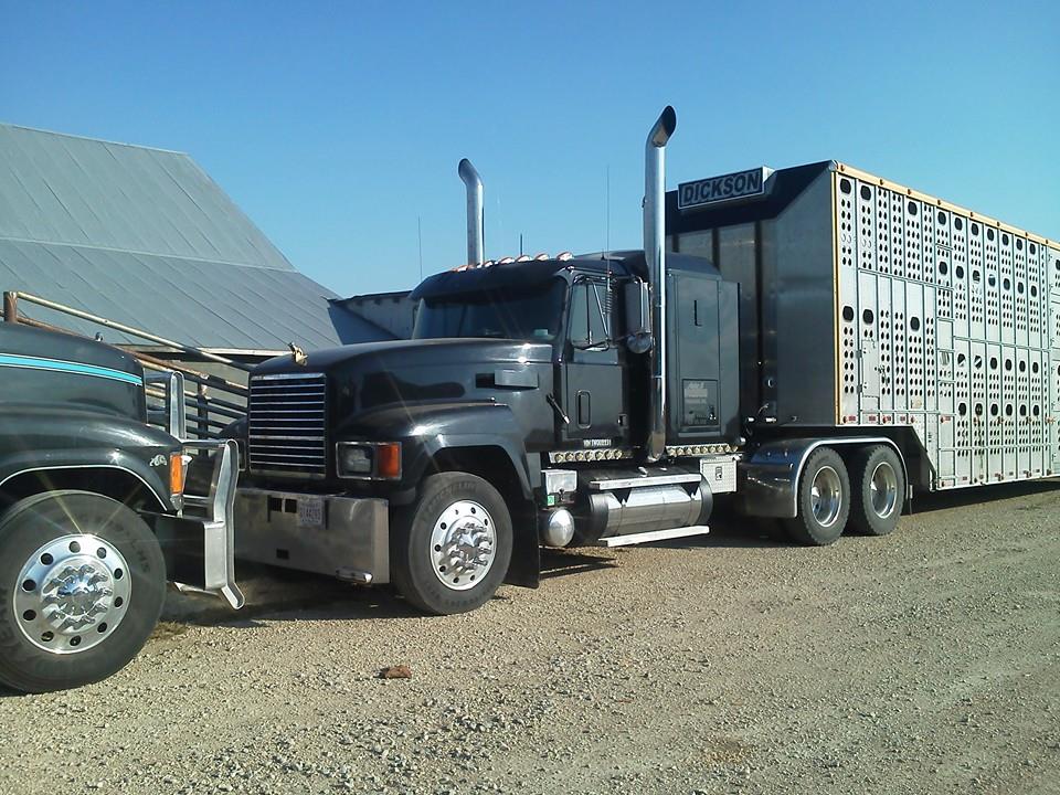

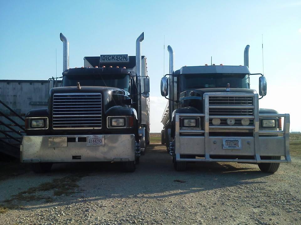

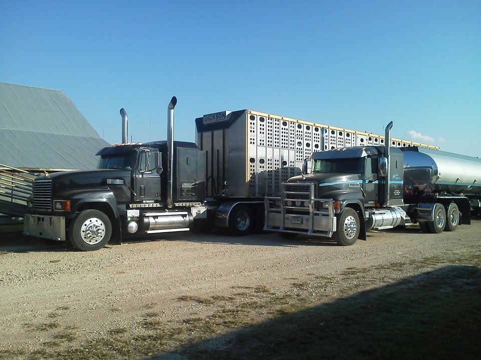

Any info on this:Long hood CHN
I still want more pics of that truck, and any contact info would be great too, id buy a cl if i could make that happen.

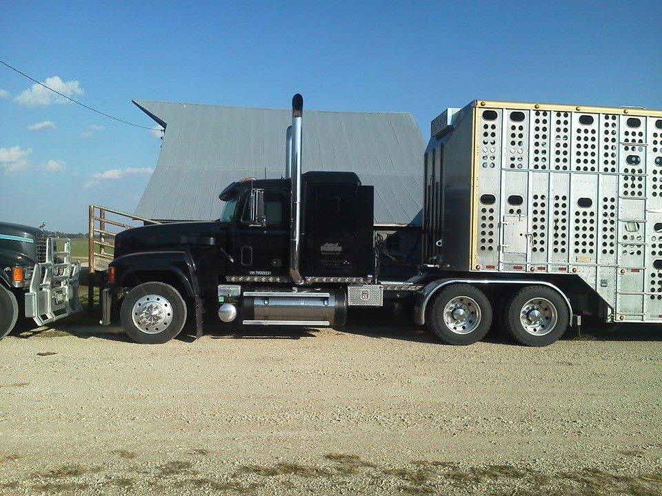

It belongs to Dickson trucking out of stafford ks. The family also farms and they used to run black ch's with aluminum grain beds always shinny and clean. They bought the cl and did the work themselves I believe. Made it an axel forward and they used two hood to make one. As far as specifics I don't know I used to see the truck at my grandpas shop but I don't see it very often anymore.
Yeah that's custom folks, take a good side view of a ch set forward, not even close.
Superliner II andMH springs and hangers are the same and both will bolt in place under a CL.. RW MH and CL are built on the same frame assembly CL just uses a longer spring and front hanger. If you look close on most CL's the holes are already punched in the frame rails to bolt Superliner and MH front assemblies under them. The stretching of the hood would be more work than changing the front end. So it really wouldn't be that big of a deal to do a forward axle CL conversion. I think finding a good cheap CL with an E9 for an affordable project is probably the toughest part.
