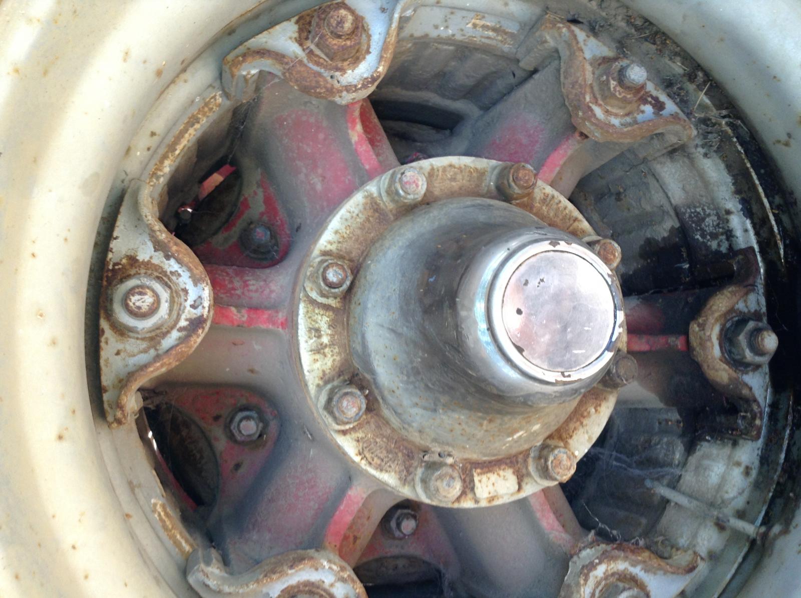

What hub is this?
post-17290-0-07624700-1411793658_thumb.jpost-17290-0-07499900-1411793685_thumb.j
I would think you have 44's not because they have six bolts but as far as I know 44 and up have those type of axles

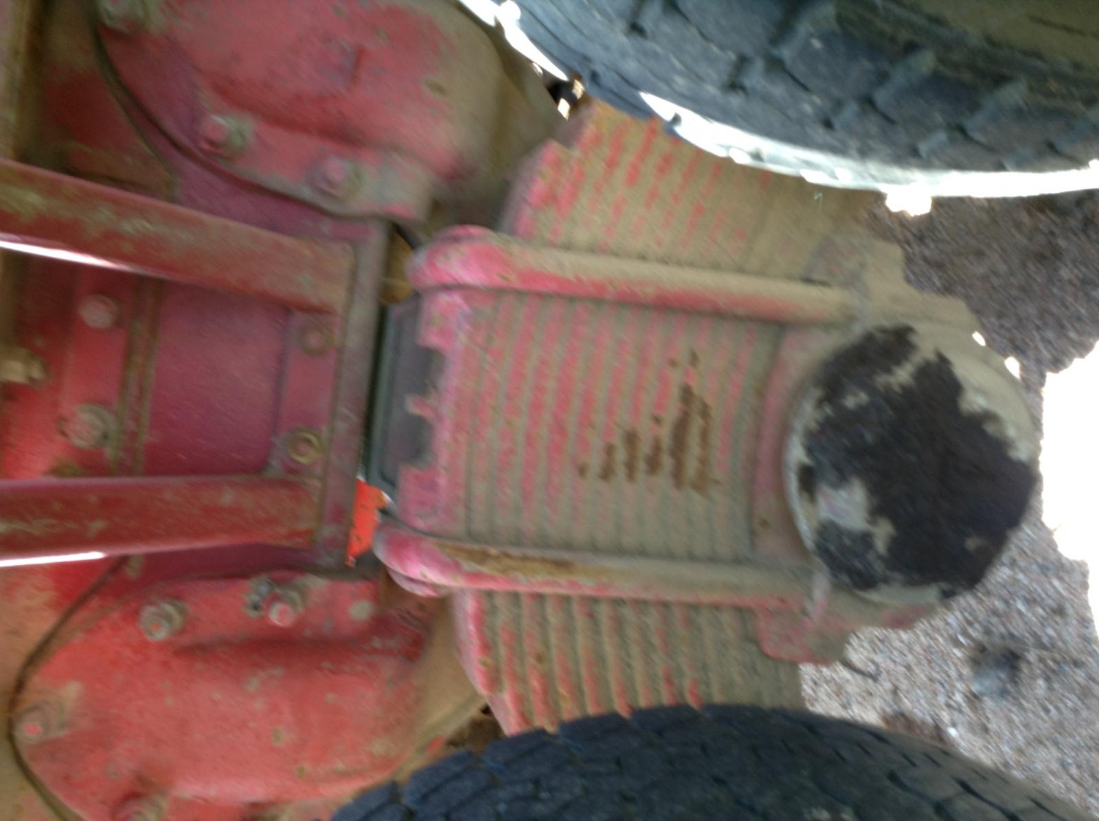

Here is a picture of mine because I have 58's and they have 8 stud and are chrome with a slight tint of rust these days they always weep oil out from the center where the welsh plug is have had a couple of goes at trying to fix it over the years but it dosnt drip it just sought of stays wet but not wet to touch I guess its rust proofing perhaps
As you can see the spring in mine is huge it would be twice as big as 34's or 38's and at least half as big again as 44's rides as rough as guts when Im bob tail but once theres a trailer on it smooths right out I have thought about taking leaf out of the springs to try and improve the ride but then I just think man a bit Paul
Paul

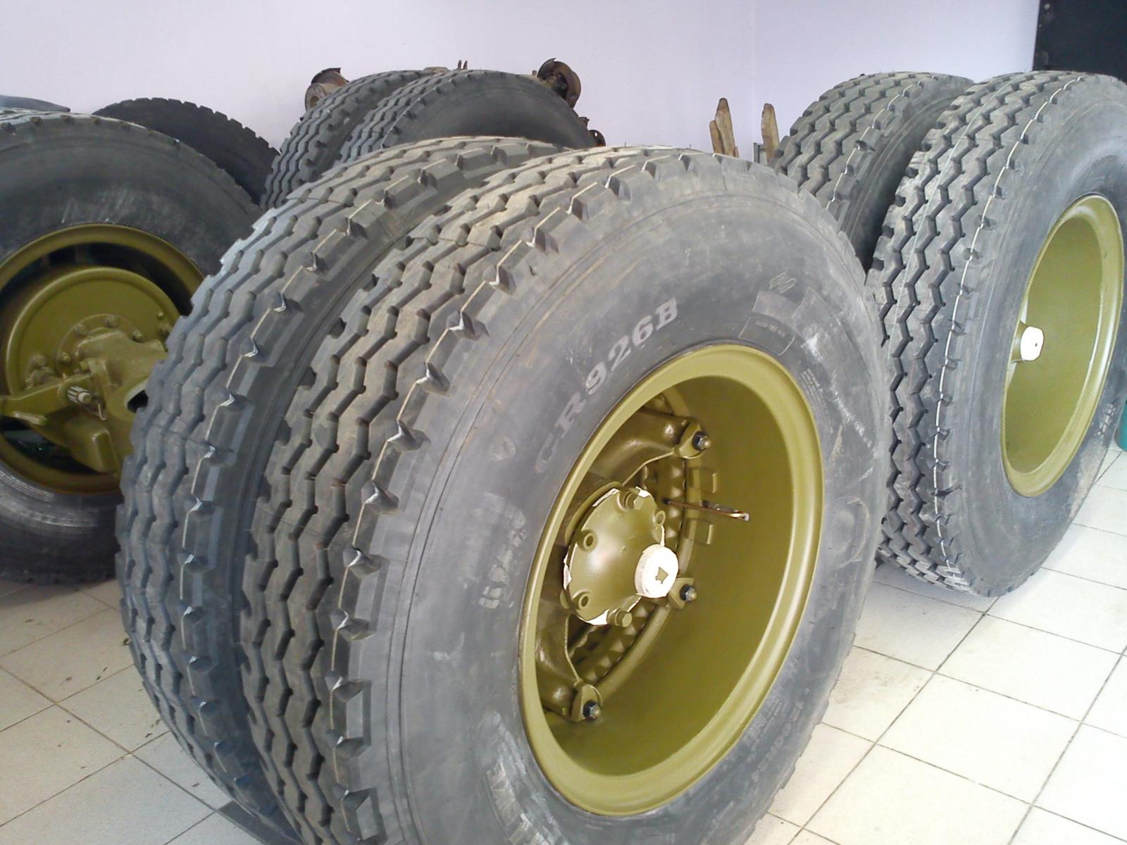

Here's what I have on my 1945 NR.
If you really want to fit baby moon's you may fabricate any bracket to put under hub cap bolts. They're long enough for.
But I have neither ideas on where to find ready ones. Those caps are pretty high to be covered with crome covers though.
