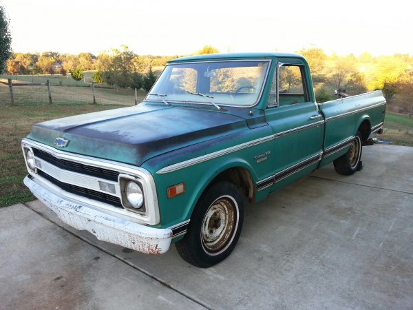

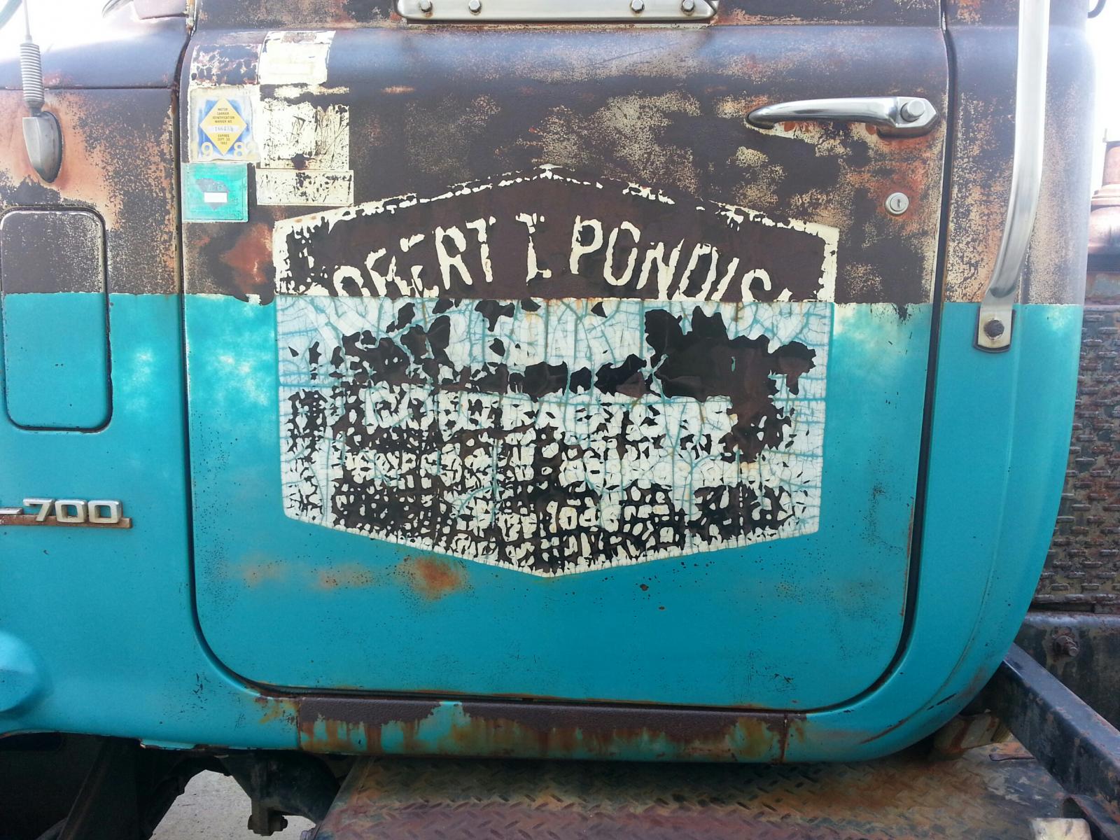

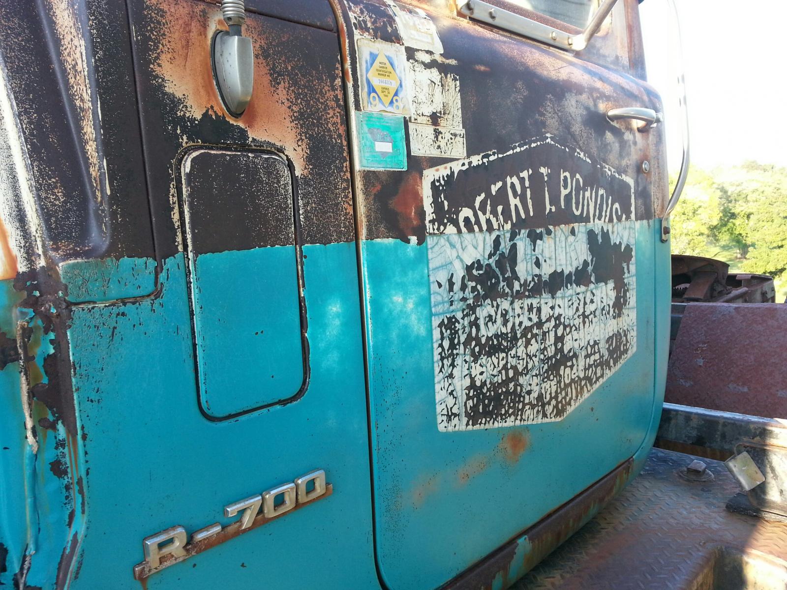

Glad you like Chassis Saver,love that paint!You can use the linseed as a rust proofer also,the aviation industry used it for many years on airframes.I rub it on then wipe off the excess,after that rub it out with a second rag.Make sure to get "boiled linseed oil",it has drying agents in it.I'm sure if you wash the truck a lot it would have to be re done after a while but a little bit goes a long way.I did an old Chevy truck with it a year ago that sat outside this whole time and it looks like the week I did it.
Sold the Chevy a little while ago,was an original paint 1970.Nice thing is once this stuff cures you could rub against it with a white t shirt and nothing will get onto it!You won't get dirty or need a tetanus shot while enjoying your truck,finish looks like it's satin cleared :twothumbsup:.Yarnall your red White would be a great candidate for this also(if you still have it).Here's a door pic from this afternoon,drying up nice after some time and a few more rubdowns.

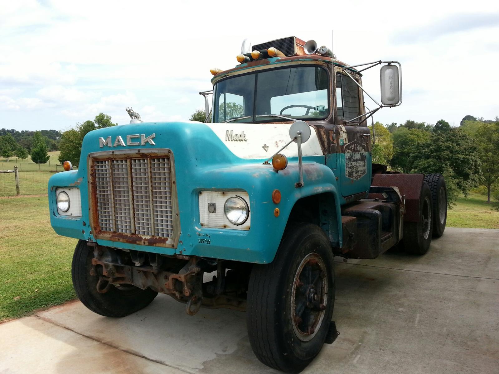

post-2598-0-01384800-1411126952_thumb.jp
post-2598-0-26498300-1411166620_thumb.jp

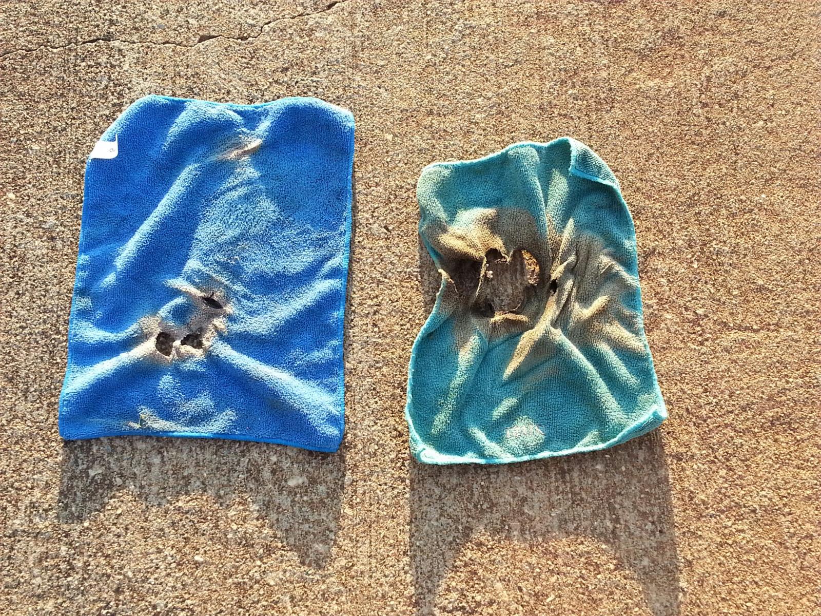

post-17364-0-98443700-1411172496_thumb.j
