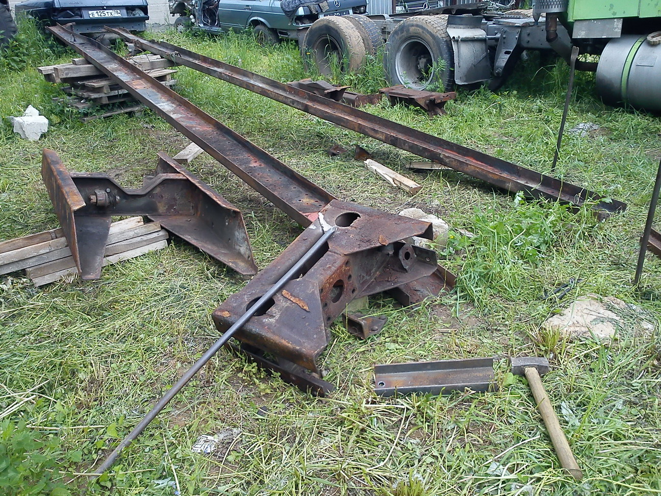

You mean the expanding foam wasn't doing a good job of keeping everything together?!
I think the foam was used to try to keep the spreading from getting worse, but as you can see, it didn't work.

I have a 88 superliner on hold to restore but when the V-8 became available, I decided to make it a donor for the frame. The frame is in excellent condition for this project. V-8 was a double frame and the donor is also.post-147-0-44083500-1398295720_thumb.jpg

The one in the picture seems to me as a perfect double frame.
Just no spread as far as i can see.

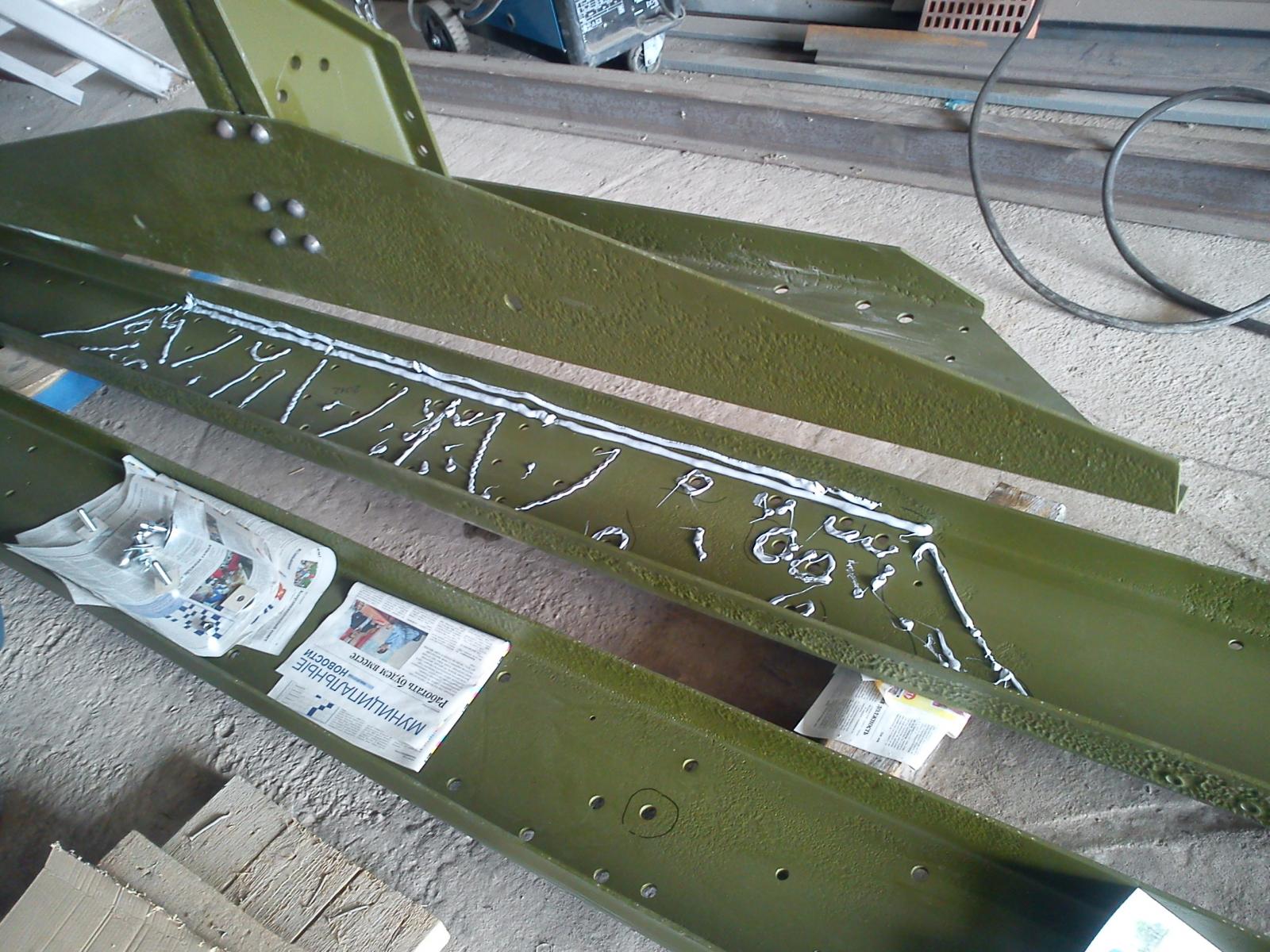

There were many talks about them double's issues and I too liked the idea of drilling holes from an inside and putting grease fittings in inner rails. So you can fill up in between. Just don't greaze it before painting.

I also provided repair of the frame on my 1945 Mack. It had the single rails but with a big "butterfly" crossmember in the bogie area. There was a lot of rust and spread. I had it apart totally an sand blasted. Than painted everything separately and applied liquid seal in between.
post-3971-0-00611300-1398363106_thumb.jp
post-3971-0-82915300-1398363233_thumb.jp
