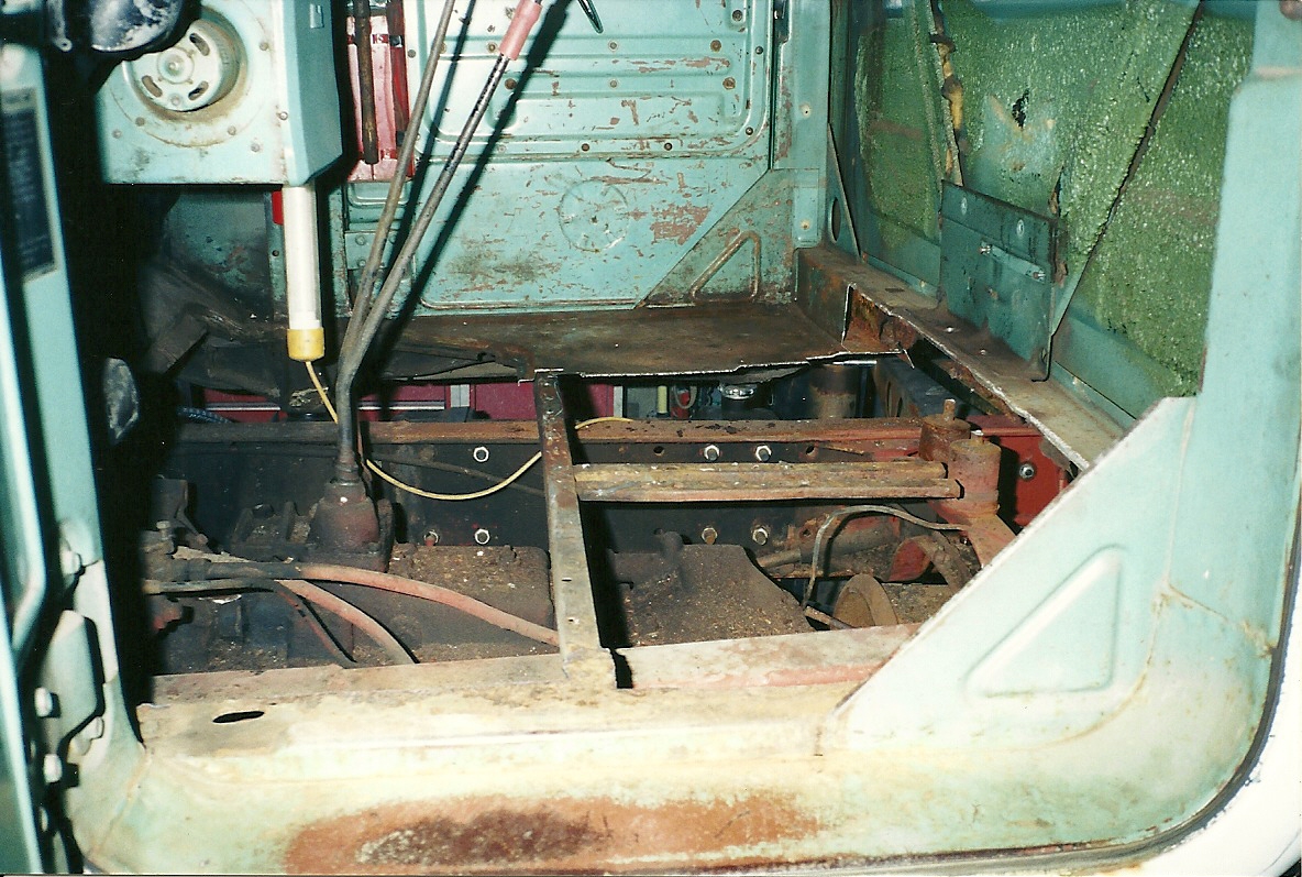

Near as I can tell Justin,the R's had stickers for the shift patterns and the operating range. I used a B model shift pattern plate in my truck (seeing it is part B anyway!). The operating range plate for B could be used. Probably easier to find than the decal.Although these decal guys can make just about anything these days,with a good example. (Had to dig into the BCR's cab a little too!) Al
Ok cool I didn't realize they were stickers in these trucks. I know someone who can make decals, I'm sure I could find a good example online for him to copy from.
Looks like quite the job on that floor! Luckily mine didn't get to that point, I only have a couple small spots I can cut out and replace. Soon as I'm done with the cab corner and rocker.
