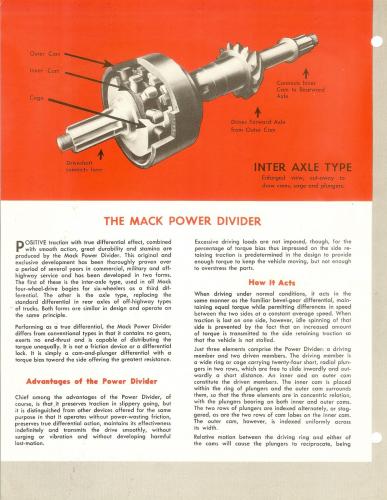

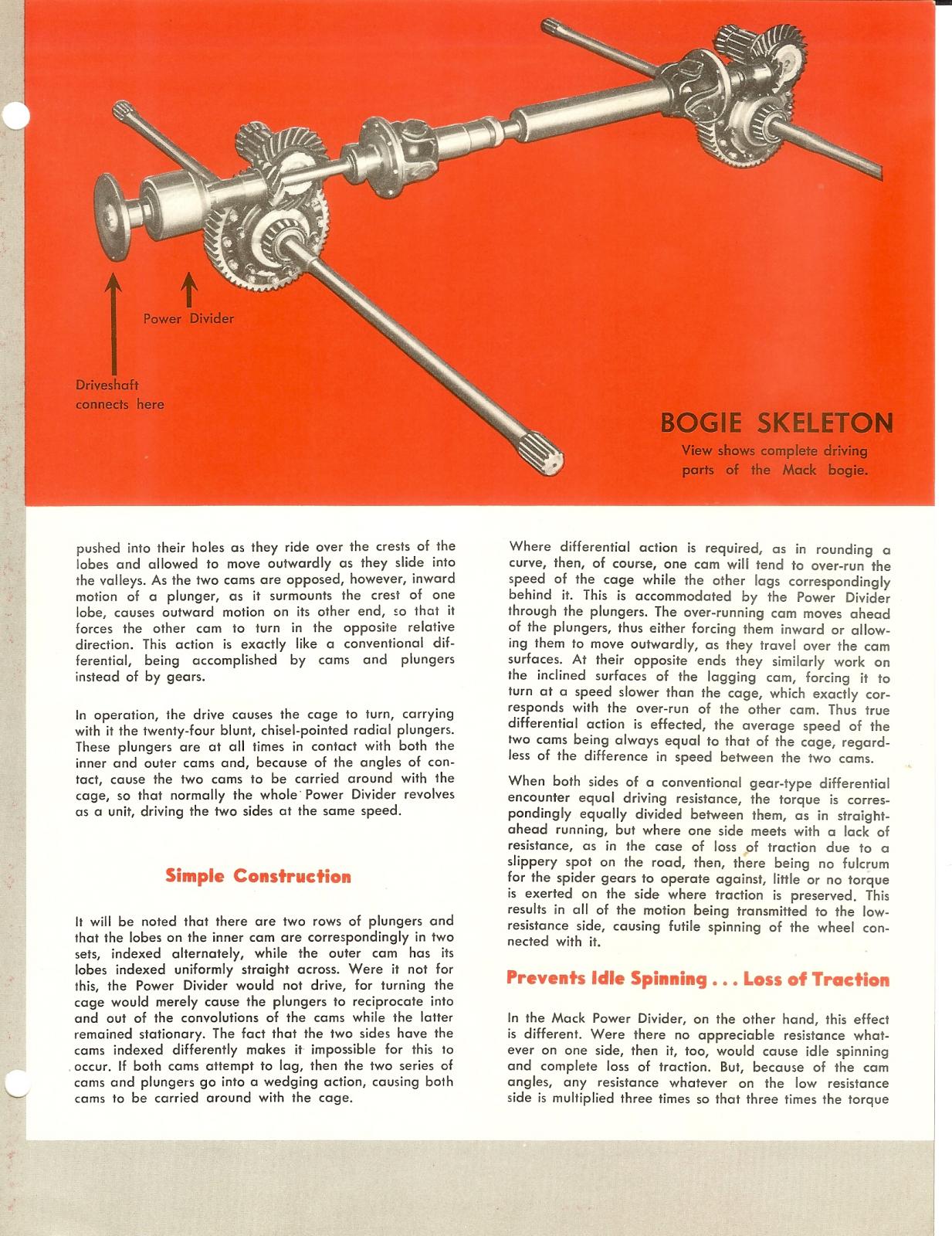

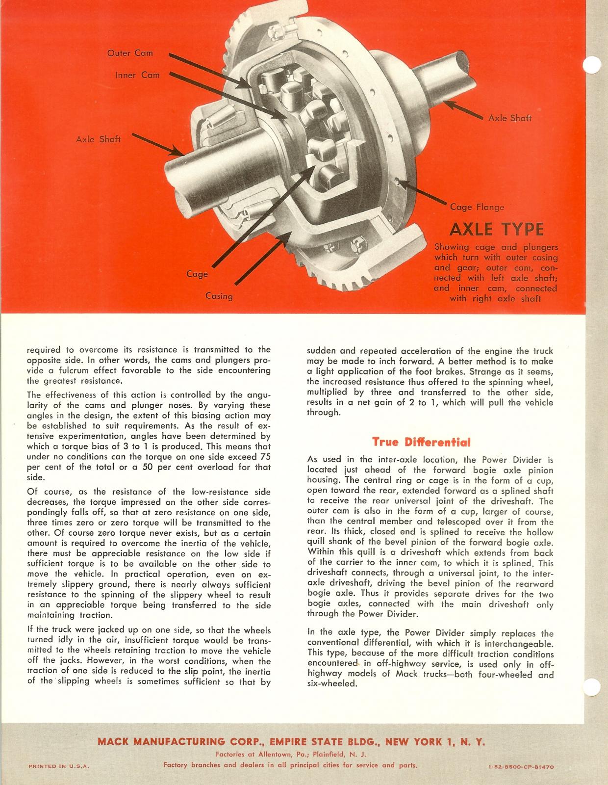

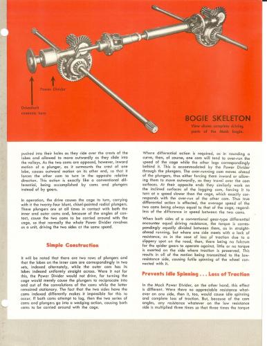

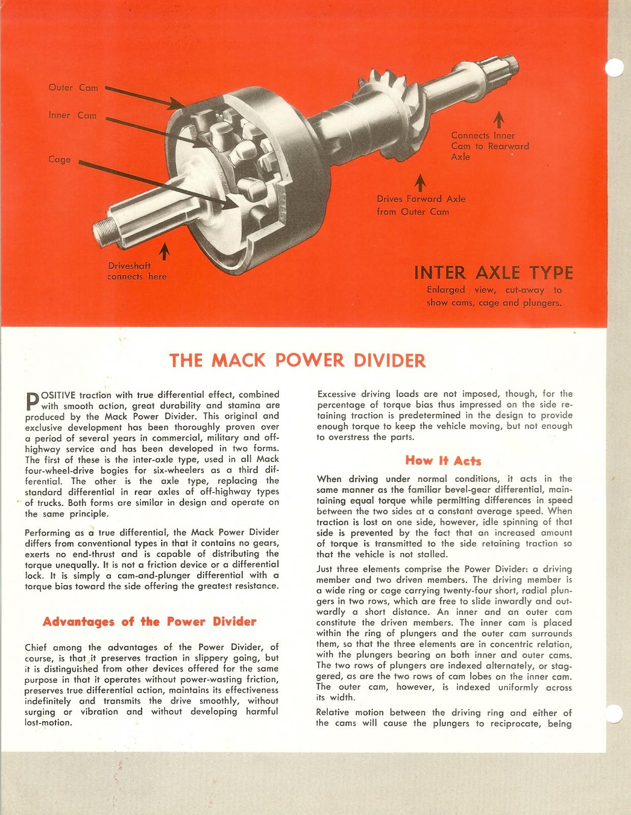

Next time it slips, if it is a Mack rear try applying slight pressure to the brakes. By increasing the amount of torque it takes to spin the tire with no traction, it can send more power to the wheel that has good traction...hopefully enough to move the truck. Somebody posted an article a while back that explains how it all works, and if nobody posts it by the time I get home tonight I'll try to see if I saved it.

90plow if you look at the last page that Rowdy Rebel posted the one titled AXLE TYPE is a picture of a limited slip diff. it works on the same theory as the power divider just side to side instead of front or rear. contact your local gear shop and see if they can get you one
