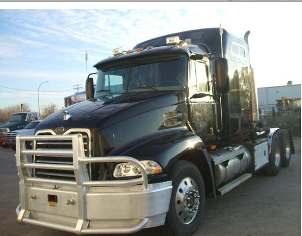

Thanks for the info bbigrig, my engine has a wastegate turbo on it so maybe it is the 485hp engine. i plan to pull super b's with it and will be grossing at least 120,000. i pulled the plugs and there was a few little pieces of steel on the magnets of both diffs but I'm thinking the oils is pretty old, maybe original, and since it has diff locks maybe they were engaged while still spinning once and made a few pieces… hopefully nothing serious. Heres a pic of the beast

Neat looking truck, looks like a hard core Mack already with that grille guard.
